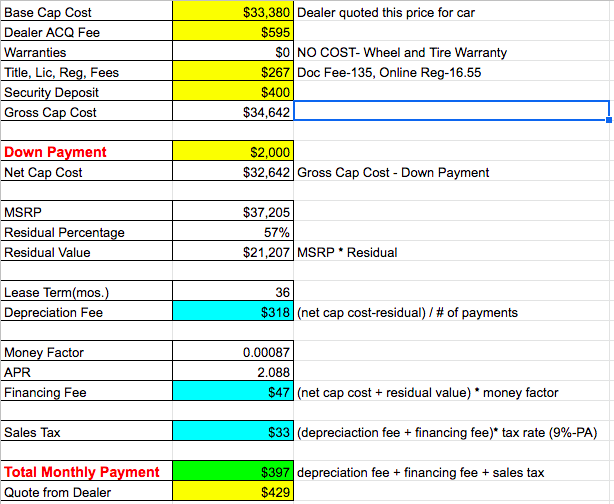

  • lars1281lars1281 Member Posts: 36
    Need a check o a quote from a dealer. Lease 2020 Accord Touring 2.0T. Zip: 19053.
    Numbers follow... I come up with $384/month. Dealer comes up with $429. I am making assumptions on Dealer ACQ Fee and Security Deposit. Can you help?
    The acquisition fee is $595 for Honda.
    Are you applying the $2000 twice?
    Once for the difference between "negotiated selling price" and "base cap cost", and then again between "gross cap cost" and "net cap cost"?
    Also, I get $252 as the "depreciation" portion of the payment ($9068/36). Double check the formulas in your spreadsheet.
    Ask the dealer for a copy of their lease worksheet.

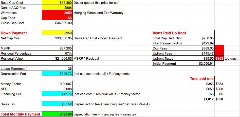

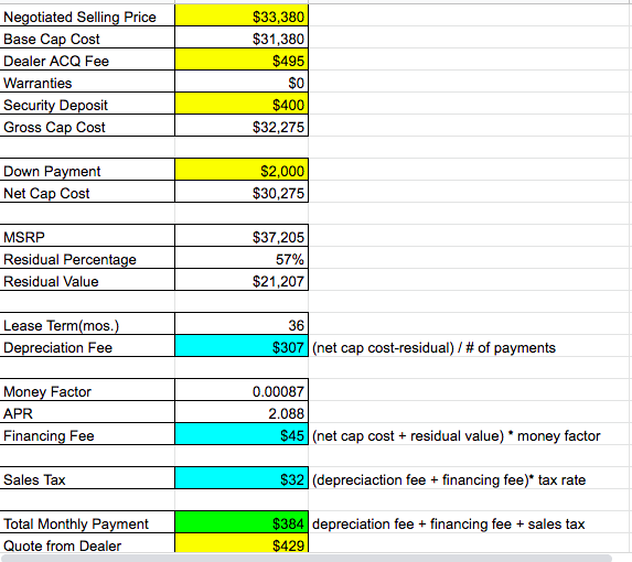

    edited March 2020
    You were right.. I was counting the down payment twice. Here are the revised numbers.. lmk your thoughts on the deal... It includes a tire/wheel warranty....
    Now I agree with your math.
    There are only two places where the dealers numbers can be different than yours - the net cap cost or the MF. Confirm what the dealer is using - you sure the tire/wheel warranty is free?
    Now that I see the IM's from the dealer(yes, doing this via IM with Corona).. he said "i am willing to add the tire/wheel protection for $459 with $459 down payment" - NOT FREE.
    I finally got the dealer to send his lease sheet. A bunch of extraneous charges... Also he charged me $659 vs. $459 for tire/wheel warranty. I think this is $550 - $1000 over what is reasonable. Thoughts?
    Can i please have numbers for the Sport 1.5T automatic for 36/12k in 92694. Greatly appreciated.
    .00087 and 59%
    $500 incentives
    I'd pass on the tire/wheel warranty, altogether.
    We don't determine what is or isn't reasonable - Edmunds tracks pricing, here:
