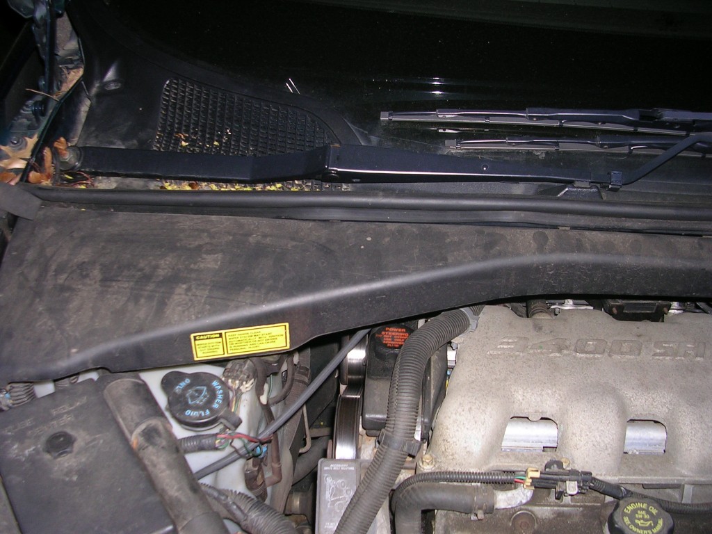

  • fleastifffleastiff Member Posts: 52
    Yipes!! What happened??????
    I went out prior to my being caffeinated to just lug some bags of garbage to the gate. No big deal. I probably wasn't fully awake. There was a bit of overnight glaze on the windshield so I started up the wipers figuring a few swishes and I'll see through the windshield more normally. There is this great big noise and something big and black falls off the windshield onto the ground. I figure something from a tree must have fallen onto the car but when I get out there is this two and half foot long tapered plastic/black-rubber thingie with a yellow placard on it: caution wiper system starts without engine running. Now remember, the hood was fully closed at the time.
    So where does the part go back to. As part of the oil change I think they check wiper blades. Did they remove something from the engine compartment but leave it up there in the wiper-well? Did it get blown off by the engine start-up? Or by my turning the wipers on? It seems to be from the engine compartment but with the hood closed, I think they never replaced it. Wow. I sure ain't never going back to that quick oil change place. But what about the 400.00 mechanic job? They never noticed it either? And I've been driving it around since? Just never used the wipers until this morning. Anyone able to figure out exactly where I put it back? Anyone think that mechanic was wrong to not notice something was amiss?
  • 442dude442dude Member Posts: 373
    Yipes is right...I'll take a look at the Venture when I get home, sounds like the cover that goes over the mechanicals for the wipers...they probably took it off when they changed the plugs or wires...it probably clips right back onto the cowl...I'll post a picture...
    Everything seems to be happening to it all at once.

  • k00l4idk00l4id Member Posts: 10
    Are you losing coolant at all? Second is it trying to roll over or is it dead at the key? Turn and nothing happens.?
    I think this is a picture of the thing that you described
    It just clips to the metal cowl above the mechanism for the wipers...
