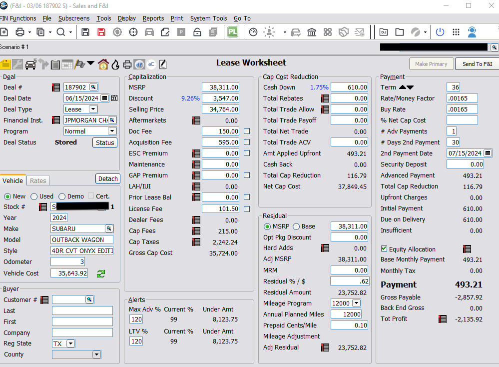

I received the following today on a 2024 Sub Outback Onyx 36/12K MF 0.00165 and RV 62% for 78566:
I’m assuming the price issue is the 9.26% off MSRP. Invoice from JDPower is listed at $33,812. As of now selling price is $952 above invoice.
The only part of this that is not making sense to me is that when I plug every value exactly the same as the Lease Worksheet onto the Leasehackr calculator I get $454/month instead of $493.21…
https://leasehackr.com/calculator?make=Subaru&miles=12000&msrp=38311&sales_price=34764&months=36&mf=0.00165&msd=0&dp=0&dealer_fee=150&acq_fee=595&disp_fee=300&taxed_inc=0&untaxed_inc=0&rebate=0&resP=62&gov_fee=101.5&sales_tax=6.25&demo_mileage=0&memo=2024 Subaru - Outback - Onyx Edition AWD&tradein=0&fin_sp=34723&fin_taxed_fee=0&fin_untaxed_fee=0&fin_term=60&fin_apr=0&fin_dp=0&fin_rebate=0&fin_ps_rebate=0&fin_tax=0&keep_term=60&exp_rv=0&service_fee=0&monthlyTax_radio=true&cap_tax=true&bmw_demo_25=true&lease_result_mode=true&dealerFee_check=false&govFee_check=false
If I remember correctly… every $1,000 in the price is equivalent to roughly $30 on the monthly payment, yes? The dealer installed package amounts to $861.
There’s still a $500 to $600 difference in vehicle price that I can’t put my finger on… Could it be that they are adding GAP even though Subaru leases already include GAP? AM I overanalyzing the deal?
Please advise and thank you in advance!
Also, I just saw a change in the advertised discount off MSRP. They lowered the discount by $1,000
It's just math...
It's just math...
A-HA! I figured it out... There's a section on the calculator that I need to click so taxes are calculated on the full vehicle price (the TX way) instead of just the depreciation. once I click on it, then I get the same numbers.
