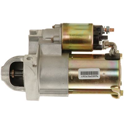

    I have a 94 Bonneville and i am having trouble with the security system. The car has power and the starter is good but the car wont turn over. There is no power to the starter. does anyone have any suggestions?
  • imidazol97imidazol97 Member Posts: 27,806
    The starter is good. How do you know that?
    When you say the car has power, does the starter have power. There is a problem with corrosion building up between the two or three positive cables that are overlapped on the battery. Those need to be clean.
    When you turn the key to ON the security light should come on and then go off after a few seconds if the key chip is being read as correct. If there is a problem with the VATS security system, the security light will flash for three minutes and the starter and injectors will be disabled. That occurs after the third time you try to crank with a bad reading for the VATS chip.
    If you are not getting an error with the Vehicle AntiTheft System, try having someone tap on the solenoid on the starter while you turn the key to crank. Many times the solenoid does not make contact and nothing happens when the key is turned to crank with a bad starter. The small hammer or object can be tapped against the solenoid down under the front of the motor.
    The solenoid is the sausage sized cylinder on the starter housing.
  • cargirliecargirlie Member Posts: 2
    the starter was removed and tested
    it is a defanate problem with sacureity
