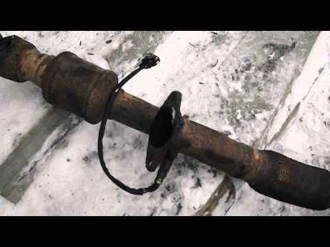

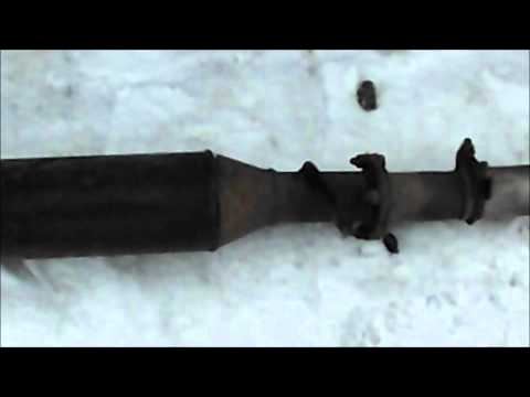

    2003 Saturn Vue Reduced power/ Service engine soon light problem solved Bought my 16 yo daughter 2003 vue. It did this a few times. Found these videos. Hope it solves your problems. I'm replacing mine this week. Hope it works. http://youtu.be/uLrml177ygc
    http://youtu.be/tuWvpe13JFc
  • mccollins19mccollins19 Member Posts: 2
    Forgot to say the 2003 vue we have has got 168,000 miles on it and had the transmission replaced at 132,000
