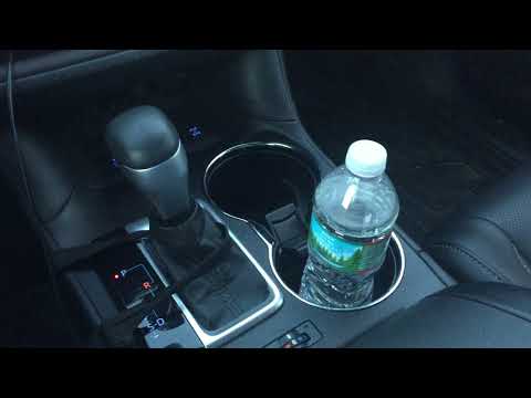

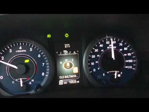

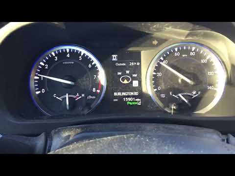

    Total views are now 625 and counting....I hope Toyota sees this Blog and take some action! Reposting the video, in case you missed it.
    BEFORE TRANSMISSION REPLACEMENT.
    https://www.youtube.com/watch?v=-xyQn9TFdqU
    ISSUES AFTER Transmission Replacement
    https://www.youtube.com/watch?v=_ZnLB31jVNk
    https://www.youtube.com/watch?v=TPOUQ3AcGs4
