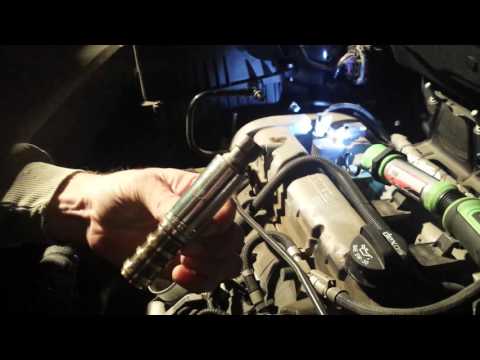

    If you want to learn more, there are videos showing R&R for intake and or exhaust actuators. Use at your own risk.
    https://www.youtube.com/watch?v=YK4f96ZzJGs

  • capecodbeachfrontcapecodbeachfront Member Posts: 13
    Thank you. The video shows how easy it could be BUT I am not that brave. Fingers crossed the dealer does not turn this into a 'it could be this or it could be this' adventure. My guess... the 10 minute video I just watched turns into a 3 hour labor job.

    I included the video because if someone does some work around their car and is comfortable with how the taking off the plastic beauty cover works on their engine this can be a do it yourself job. Many on the Malibu forums have replaced the intake and exhaust actuators when they throw a code, some from defects or failures, some from clogging due to poor oil hygiene, in my opinion.
    The hardest part is likely removing the clip that holds the electrical connection onto the intake valve cam actuator. Those sometimes are hard to figure out how the safety lock has to be worked to release the clip to be able to remove it. They are secured to prevent coming undone in normal use.
    Some video people take time to explain how the rear of the plastic cover is undone, for instance, some don't. Some video makers explain and show how the safety clip on that particular electrical connection is undone.
