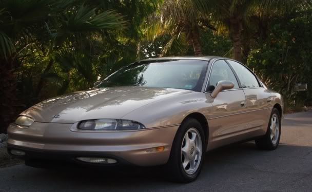

  • patsmaleypatsmaley Member Posts: 12
    www.carspace.com/patsmaley/Albums/
    here some pics of my 97 aoura please let me know what you think
    www.carspace.com/patsmaley/Albums/ please go to me web page and see my car and let me know what you think thank you
