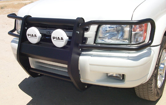

    It's purely cosmetic IMHO. It curves in toward the body too much and is way too close to the body to provide any protection. How much is it going for?

    $450 for it(ouch). Seems thicker steel compared to the thin Manik stuff but still no ARB bumper. Some people still like this look so atleast they have another option for the Trooper(Paisan, look how many SUV in NYC have them).
    Cheers,
    Con
