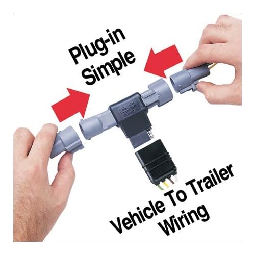

    In the future, I plan use our new 2003 FWD RDV to pull our 4x6 trailer. My son is disabled and I often use our light weight 4x6 trailer to haul his 3-wheel peddle bike around. Especially for the 1.5 hour drive to our seasonal camp site. I know a Class II or Class III hitch can be installed on my new 2003 FWD RDV. For me, I'd only install a Class II - for our light weight 4x6 trailer. For larger / heavier trailers, I'd use our 2001 AWD Safari van instead. If wondering, I also plan to install the properly sized Aux Tranny cooler (plus 1 size larger) in our 2003 RDV as well.
    To install the "most common" 4-Way Flat Trailer Connector, I noticed that a 2003 RDV Vehicle to Trailer T-Connector can be purchased. It looks something like: http://ec1.images-amazon.com/images/P/B0002YH0J8.01-A1PVVMQ30UW2Y0._SS500_SCLZZZ- ZZZZ_V43273164_.jpg
    For the 2003 FWD RDV, where would this plug be located in the rear hatch area? I'd like to know the approximate area to reduce my time removing plastic panels or getting frustrated time looking for its "split / connect" T-Connector wiring area.
    Many thanks

  • spike99spike99 Member Posts: 239
    Many thanks for stating I need Rear Wire harness #18 and to confirm its wire lead colors. Much appreciated.
    Also found the below "Plug to Trailer" harness wire. Sounds like I only need to find #18 plug and buy one of these. re:
    http://www.innerauto.com/store/buy.php?make_text=buick&ml=rend-cx-003&model_text- =rendezvous&year=2003&part_name=hitch_wiring_kits&brand_name=hoppy&s=1&my=1
    Again, Many thanks.
    Tonight, I crawled under the rear of my 2003 RDV. Found the #18 wire with its V92 plug under the rear of my vehicle. It appears I just need to remove its end plug (for water protection), plug in a store bought adapter and, "ready to use". Ready to connect to a standard plug on a small untility trailer.
    Thanks again for helping out!!!
