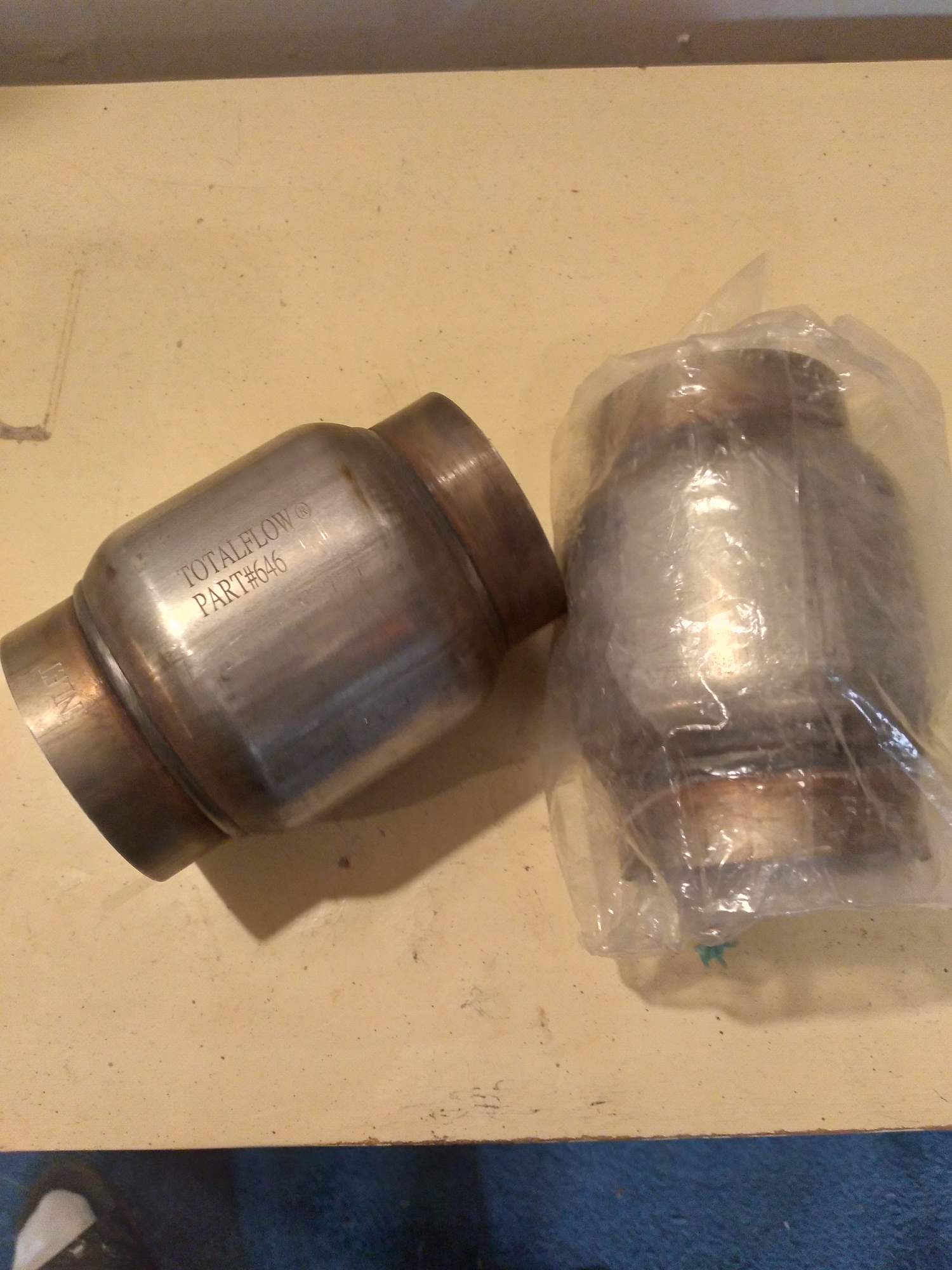

    Has ane
    Has anyone had any experience with these totalflow mini mufflers?
  • texasestexases Member Posts: 11,176
    I haven't, but you can't beat mother nature. I bet their sound control capabilities will similarly 'mini'.

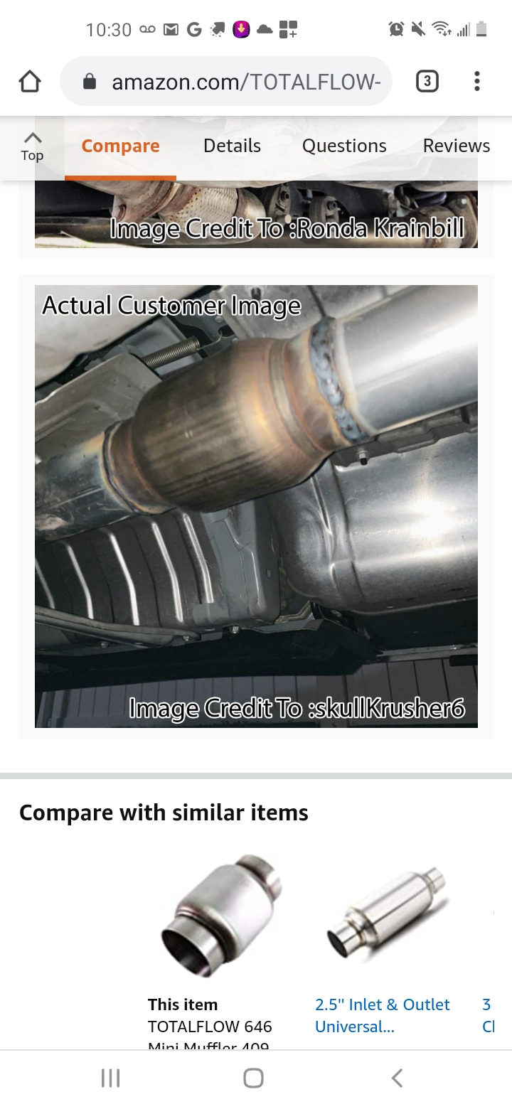

  • rickdonrickdon Member Posts: 123
    Based on the reviews I saw online, those mini mufflers are designed to tame your exhaust and eliminate the drone. But for that price, I wouldn’t expect it to last for several years.
    My car has a Magnaflow and I love how it sounds. It has a nice deepish tone and no drone at all. I got this muffler from 4wheelonline.
