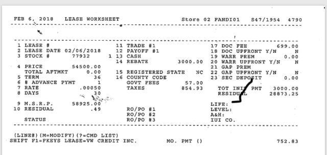

    Please comment on this lease deal and let me know where I can do better.
    V90 CC T5 with Comfort+Plus pkg with few other options.
    MSRP $58.925.00
    Sell Price $54500.00
    Term 36
    MF .00050
    Advance Pmt 1
    Rebate 3000.00
    Govt Fees $57.00
    Tax $854.93
    Doc Fees $699.00
    Residual $28873.25
    Monthly - $752.83
    MSRP $58.925.00
    Term 36
    MF .00050
    Advance Pmt 1
    Rebate 3000.00
    Govt Fees $57.00
    Tax $854.93
    Doc Fees $699.00
    Residual $28873.25
    Monthly - $752.83
    Where is the acquisition fee?
    Using the MSRP and sell price, I'm within $1 of that payment quote.
    Confirm the adjusted cap cost for that deal.
  • eejlee70eejlee70 Member Posts: 9
    edited February 2018
    Any/all observation is welcomed.
    good deal? Room to negotiate?
    Doc fee $699.00 is this normal? Shouldn’t it be $100 for A-plan?
    I have a trade in thats about $13,000, would it be wise to apply it to the lease?
    Financing the same deal comes neck to neck in terms of monthly pmt.
    Lease or finance ??
    Lease or finance ??
    Your screen shot is missing a lot of information.
    Looks like there should be another page
    How much is due at signing?
    No info on A-Plan, but the $699 doc fee is just additional revenue for the dealer. Basically, reducing your discount.
    You need all the numbers, including the acquisition fee and adjusted CAP cost.
    Putting $13,000 towards the lease doesn't change your total cost. It just pre-pays it.
