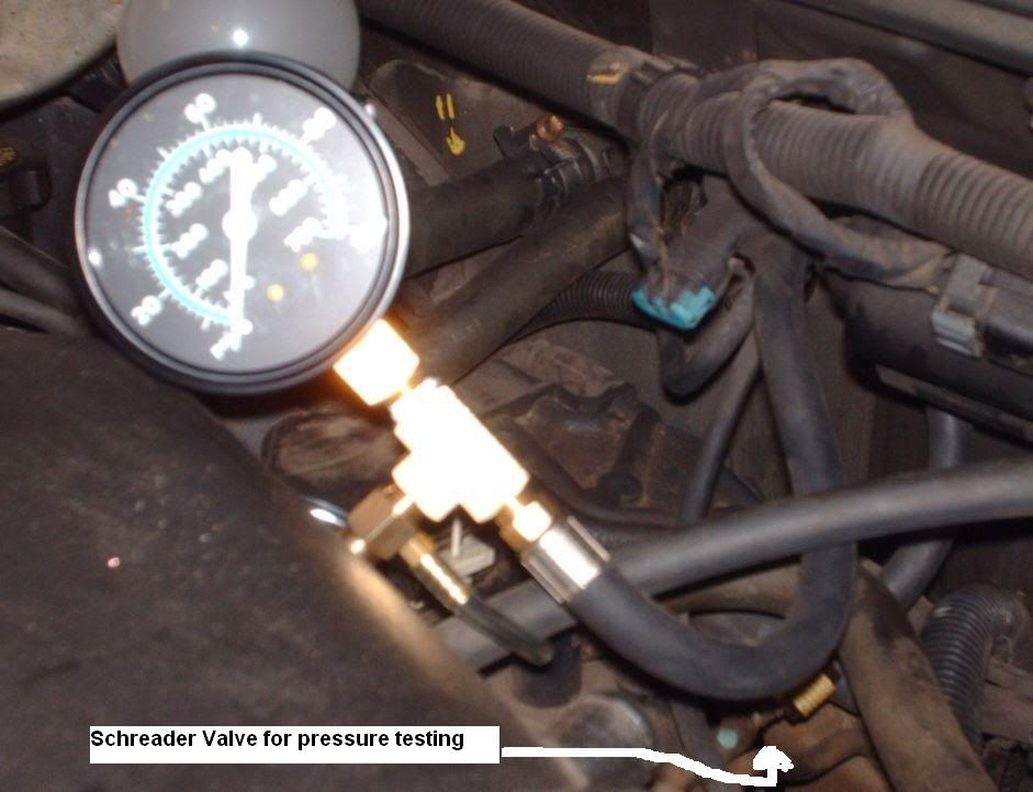

    This is a PITA, but on the fuel rail up to the engine there is a valve with a cap on it. Remove the cap and install a fuel pressure gauge. I think you need 70lbs. or somethin'? It can be done in 2 minutes. Install gauge..crank and look at pressure (through windshield with hood up).
    I bought a gauge with screw on fitting at a Napa, or Adv. Auto.

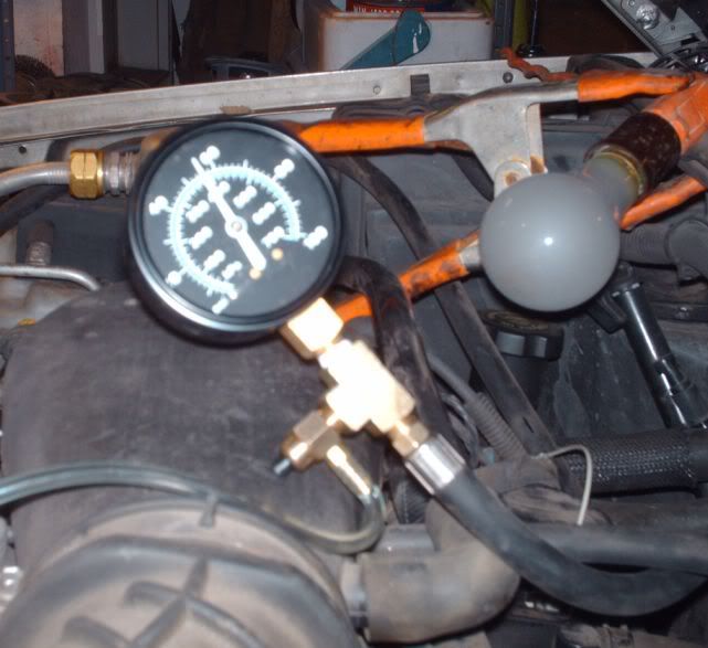

    Check the fuel pressure real quick next time it dies.

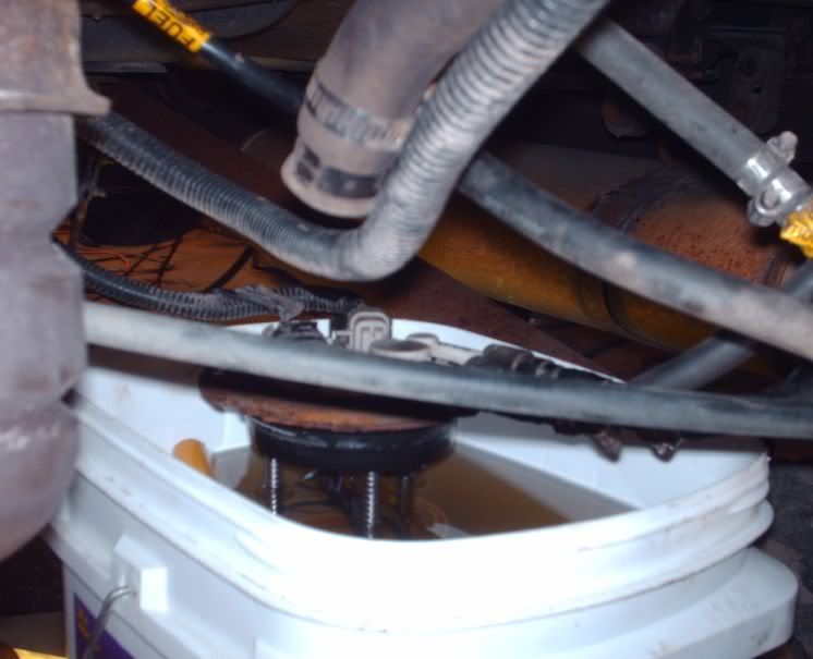

    My wife's 2000 just up and died. Towed it home...replaced filter. Nothing.
    Then bought the guage. It told me 4 lbs pressure. Got a fuel pump assy. with sender from a junkyard for $100. (I had already dropped the tank and replaced the bad sender once.)
    Replaced fuel pump assy and all is good.
    Sometimes these pumps can be intermittant (especially on the older cars...you rap on the metal tank with a block of wood and it'll start and run for awhile).
    Guage setup/location:
    I tested the junkyard pump and sender in this fashion before installing in tank:
    Guage and pump check fine:
