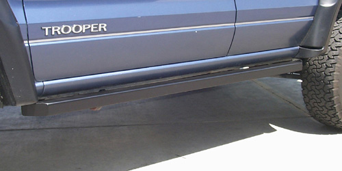

    Thanks everyone for the suggestions to prevent dents. Where can I buy boulder bars as one fellow suggested? I live in N.C. if shipping is to be a problem.
  • ryanendresryanendres Member Posts: 122
    The place to go for Boulder bars for Isuzu's is
    http://independent4x.com/
    Please keep in mind these should be welded on and the can support the weight of one side of the truck. If your not planning on going off road then nerf bars are what you want (the normal tube style)
    Can act as both side steps as well as protection. For the price it's worth getting the boulder bars from Matt @ http://independent4x.com

  • wildbucwildbuc Member Posts: 88
    I have been to several sites and so far no one lists nerf bars for a 99 Trooper (usually lists ones for 92-97)l. I am looking for something either stainless steel or steel which can be painted black. Hopefully the bars will extend wide enough to serve as a step and provide some protection from dings.
    I understand perhaps Matt can provide something. Anyone know his e-mail address or phone number?
  • conman2000conman2000 Member Posts: 158
    http://www.independent4x.com
    Matt can be reached at nytrooper@hotmail.com
    I emailed Matt a few days ago and he will be making Boulder Bars/step for my 01 Trooper(just like Crunchy's) plus a rear matching hitch mounted bar/step.
    Someone asked me what Boulder Bars are so I will try to explain(does not mean its right though) :)
    Boulder Bars: Bars to protect the sides of the vehicle from rocks(Matt calls them "Rocker Bars") which mean they need to be strong. The trend now is that boulder bars are square and not round anymore(Nerf Bars) because of the better ground clearance.
    There are a couple of side bar/step makers for the newer Troopers (Waag.com, overlander.com, and the M company I don't like) as I was thinking about these but after getting hit in the rear, I figure I want more than just a step for the sides and rear and more protection as well. Since the Boulder bars from Indy4x are about the same price, here I am. Matt can make both square and round bars too.
