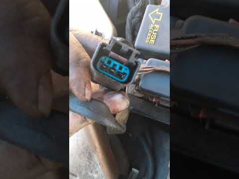

  • stoneysdead2000stoneysdead2000 Member Posts: 2
    Check your wiring harness to the crankshaft position sensor
    https://youtu.be/sNBNGwYUz1g
