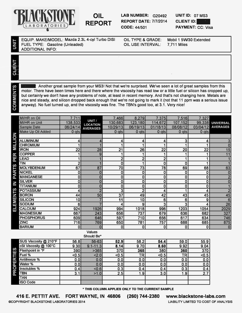

    I thought I'd take a shot at reviving this thread this thread- I've owned the car since new and I've run Mobil 1 5W-30 since the first oil change at 5,000 miles. I switched from a 5,000 mile to a 7,500 mile change interval at 69,000 miles and I switched to Mobil 1 5W-30 Extended performance at 114,700 miles. The only mods are a Mazdaspeed Cold Air Intake and a Hypertech tune:
