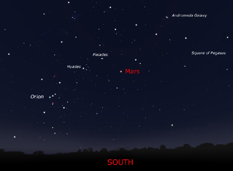

  • vger105vger105 Member Posts: 57
    You should be able to see The Pleiades from where you are. Here's what the sky will look like around 10:00 PM:
    http://www.jb.man.ac.uk/public/MarsNov.jpg
    Note The Pleiades is to the left of Mars, and looks like a fuzzy patch with adverted vision. Looking directly at it will allow you to see the individual stars. Binoculars will provide a better view.
    Good luck finding "our namesake."
