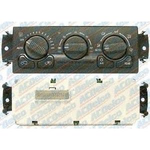

    I'm assuming this is the controller that you're referring to. Yes it does have a board in it.

    Is replacing the controls or the circuit board the solution for a temperature control problem?
    Of the controllers that I've seen fail, about 90% was the fan speed control switch and the other 10% was the directional control. Never seen a failure of the temperature control but it is possible.
