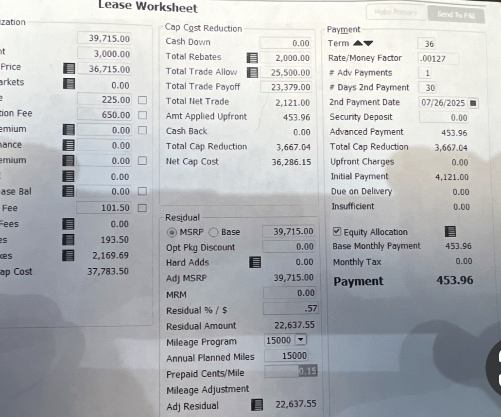

  • AgsmartAgsmart Member Posts: 36
    edited June 2025
    For @SMC99, on pricing.
    We are getting $3,000 discount plus $2,000 rebates on a 2025 CX-50 2.5 S Premium Plus AWD
    Metro Mazda in Mesquite Tx
    I have a contact if needed
    Agreed on this deal

  • CarShoppersCarShoppers Member Posts: 1
    Where did the $2000 in rebates come from? There was/is a $720 Lease Credit but the $1,000 Loyalty Credit isn't applicable to leases.
