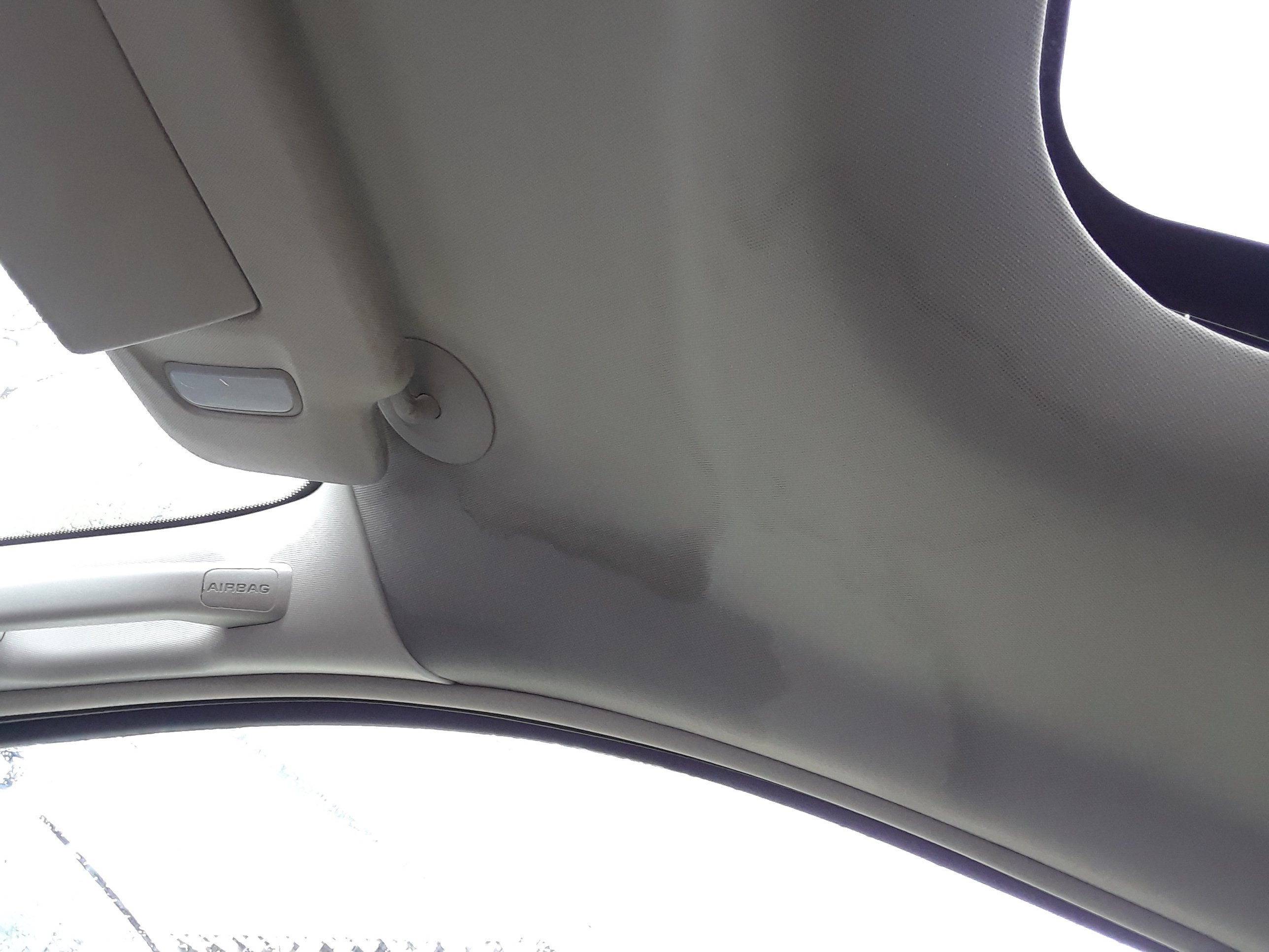

  • valgott66valgott66 Member Posts: 2
    Apparently I purchased a inside pool.07 ACADIA ALT used 187852 miles used. The dealer new I was desperate for a car only get a loan for this ACADIA. Started leaking the first time it rained took it to dealers glass people told me it was fixed. At the time life was hard my daughter needed to see doctor for cervical cancer n my grandsons needed their doctors so busy n stressful. I'm one who doesn't complain about anything just thankful for a car. I'm on disability so taking it to get fixed isn't affordable. My car is my home its a shame that I took his word it was a good car. So getting a lawyer is not affordable. Here is a video of my ACADIA pouring water from back to front passenger side. No video just picture of passenger front. Do have videos of it pouring from back to the front passenger side. Was wondering if airbags work at all have grandkids who come with me in ACADIA.
    I would have someone try to clean out the sunroof drains. It sure looks like the perfect spot for a sunroof drain clog. If you open the roof, you can see the drain holes in front and back of the rail that the sunroof runs on. Take some aquarium hose or small tubing and stick it in the hole and BLOW. Never use a coat hanger!
    You can test the drain for a clog by pouring a tiny bit of water in the hole--it should drain out under the car, behind the front wheel and in front of the rear wheel. If nothing drains out, then it's clogged and it is overflowing into the headliner.
