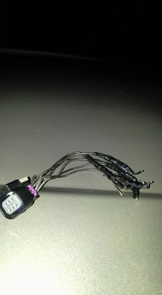

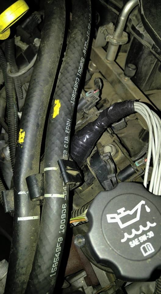

    How i fixed the engine power reduced issue on my wife's 07 impala. The first thing I did when the problem started happening was take the car to auto zone to read the code for the engine light, it said to replace the throttle body, so I did, 150$ later and the problem wasn't resolved. I ended up replacing the battery terminals (6$ jus get the cheap universal ones from any parts store).The problem was the clamps on the factory terminals weren't getting tight enough, causing the computer to throw error codes. I've read many forums of people spending thousands of dollars to no avail, try this first people, could save u alot of money and headache.
    edited May 2016
    The codes only tell you that that circuit is in some kind of distress. Diagnostic technology is not yet up to positively identifying the defective part. But yeah, wiring is often the culprit in these cases.
    Some people have found, especially the "home scientists" who actually went to the trouble of taking the TPS apart, that the "fingers" in the potentiometer part of the assembly were fusing together in some places.
