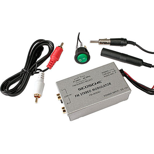

    You can head to Radio Shack (or the like) and buy a cassette-pluggable or an FM-transmitting MP3 transmitter device which gets your MP3 music into the existing radio head unit.
    Here's one:
    http://www.radioshack.com/product/index.jsp?productId=2361893&cp=2032059&f=Taxon- - omy%2FRSK%2F2032059&categoryId=2032059&kwCatId=2032059&kw=mp3+connect&parentPage- - =search
    ... here's another:
    http://www.radioshack.com/product/index.jsp?productId=2110504&cp=2032059&f=Taxon- - omy%2FRSK%2F2032059&categoryId=2032059&kwCatId=2032059&kw=mp3+connect&parentPage- - =search
    I've read that the cassette unit offers the better sound quality...
  • bigmike2bigmike2 Member Posts: 96
    Thanks, but it the one I drove didn't have a cassette.
    The cassette adapter do work pretty well. I wouldn't have a problem using the cassette adapter, but from the best I can tell, they removed the cassette player when they added the XM as standard. I would be happy to be disabused of this notion. (Anyone else have any info on recent Azera's?)
    To me, if that's what they did, it's a big marketing mistake, as so many people have ipods or competing players. Toyota is putting an audio input jack on certain Camry's and Avalon's.
    I've tried those transmitters in the past, but I thought they were less than satisfactory.
    I would be willing to pay a little extra for a custom install of an audio jack, but that may not be possible if there are no spare inputs behind the faceplate.
    Thanks again.

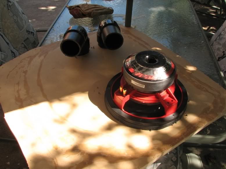

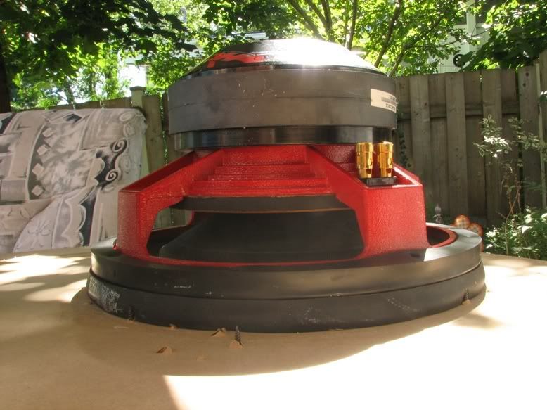

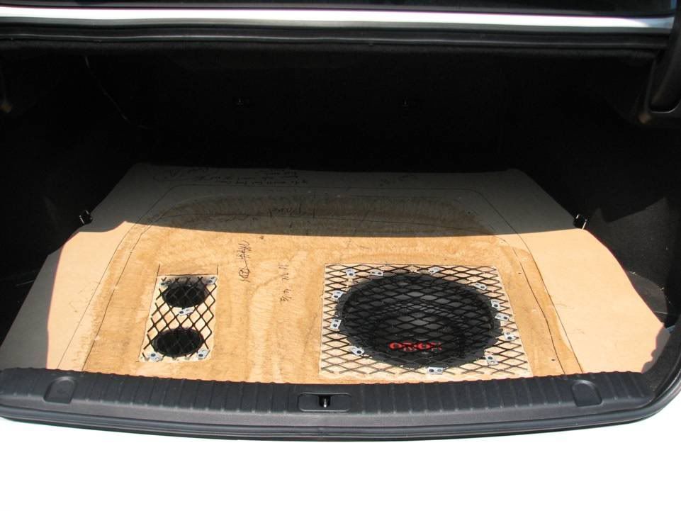

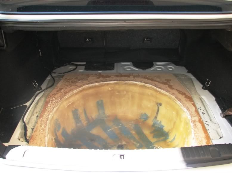

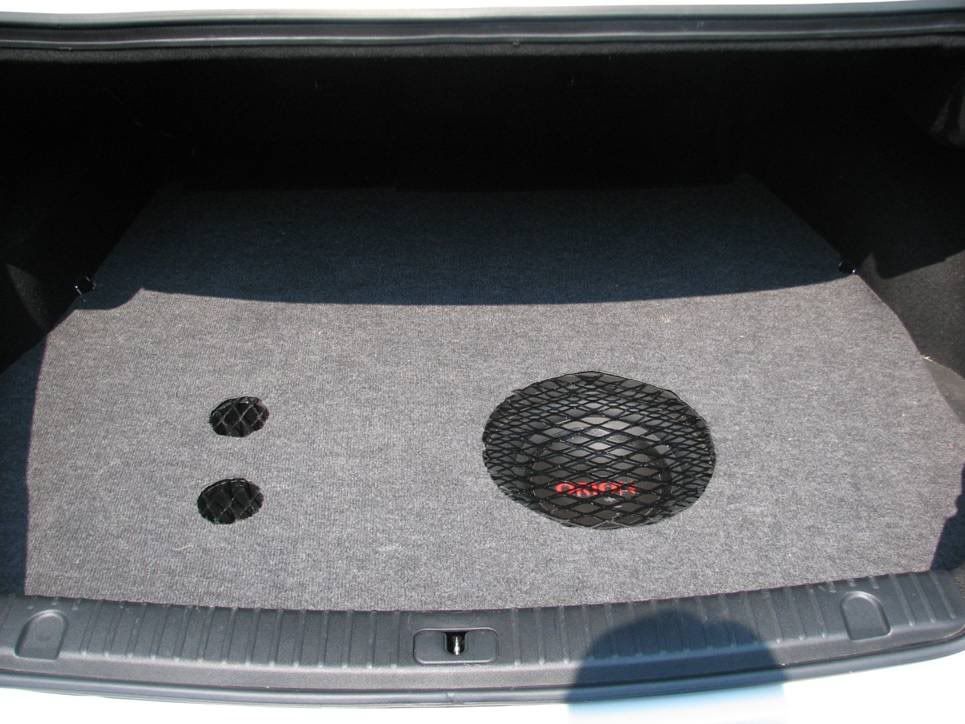

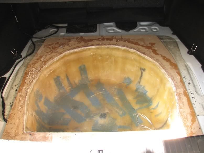

    I thought I'd share some pictures of the job that was done in placing my sub. I took advantage of the fact that one of the ports fell in and so I took these pictures while re-gluing the port that fell off.
    Here's how they did my special Sub Box utilizing the spare wheel space.
    Here's the Sub...It's an Orion HCCA 12D Driven by a Orion HCCA-D1200
    Here it is with the 2 ports
    Here it's installed with the 2 side pieces of MDF
    And finally with the temporary carpet for now.
    I have barley lost any trunk space and the sound is great!

    Quick question on 07 stock radio. Does it have an aux port in the back of the unit where we can hook up an ipod/mp3 player? Several people wrote about that AUX port in the back of the unit for other Hyundai models but nobody confirmed there was one in Azera's Infinity unit.
  • allmet33allmet33 Member Posts: 3,557
    Actually...more wattage doesn't equate to cleaner sound with less distortion. Wattage, simply put is power. The ability of the speakers to efficiently handle that power is what allows the sound to be distortion free, not to mention a clean signal to begin with. An amplifier does nothing more than boost the signal, so if the signal is "dirty", the amp will boost dirty sound which can cause distortion at lower sound levels. There are actually a few variables that equate to less distortion and cleaner sound.
    Trust me, it's not the wattage you wanna turn up, it's the voltage on the signal you want to increase. This helps to lower the noise on the sound floor.
    Music cannot be rated into watts. Any music can be played at any wattage. Concert hall music at 3 watts...trust me, all you'll hear are the strings, brass, wood winds and anything else in the mid to higher frequency range of music. At 3 watts, you will miss the lower frequencies a great deal. It takes more wattage to produce the lower notes than the higher ones.
    Anyway, back to the statement you made earlier...more wattage will make it louder, doesn't necessarly mean it'll sound better. However, in this case...it certainly will because the system is designed to be what it is. I guarantee you that if you compared a 315 watt Infinity system and play it on say 5 and do the same with the 605 watt system...you'll notice a difference. ;)
    No...there is no Aux input located on the back of the factory stereo. The only way you can set up something like that would be to use one of those FM modulator adaptors that would plug into the antenna and the sound would play via a "blank" radio station.
    However, there are some wireless adapters that do the same thing.
