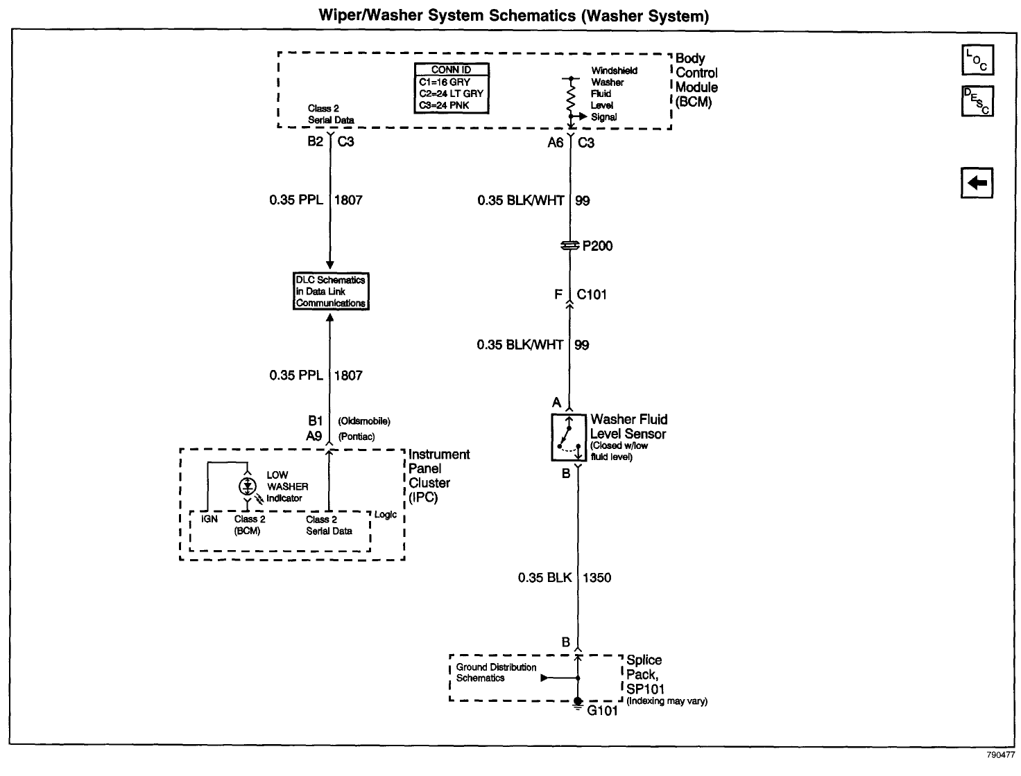

    Think your Grand Am is expensive to repair? Wait till you need a Toyota part.
    Key = $121.00
    Program the key = $48.00

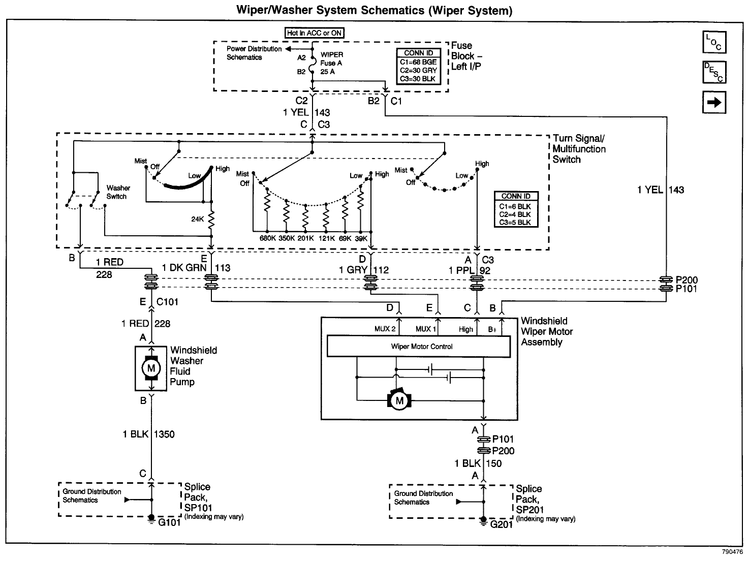

    Oh, and by the way, you can run a wire from your wiper fluid pump to another switch. But due to federal regulations, DEALERS MAY NOT MODIFY THE WIRING HARNESS OF A VEHICLE.
    Your solution is to get a service manual, find the wire you need to splice into under the dash, and do your own re-wiring. Assuming you have a Grand Am, here are links to the Wiper/Washer Wiring Diagrams for a 2002 GrandAm...
    Grand Am Wiper-Washer-Diagram1
    Grand Am Wiper-Washer-Diagram2
    The wiring for the Washer Fluid Pump is at the left side of Diagram #1
    I hope this helps. Good luck.
    R.B.

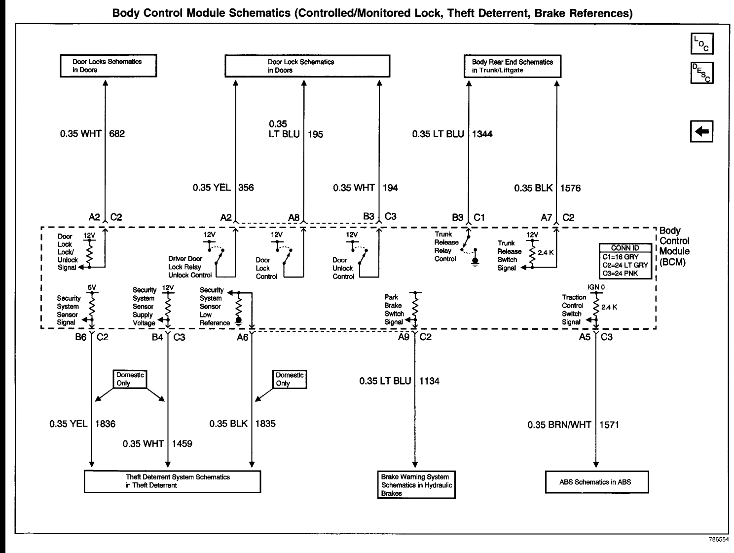

    When your "Security" light remains on solid (not flashing), it indicates that something is wrong with the anti-theft system, usually either an open or a short in the wiring or in the passlock module attached to the lock cylinder.
    Do the following.
    1. Make certain that you did the bypass procedure correctly. If you did, then you should have connected a resistor of 1500 ohms to 3300 ohms between circuit #1835 (black wire) and circuit #1836 (yellow wire).
    2. Remove the kick panel from beneath the dash on the passenger side. It is held in place by two fasteners, one just below and to the left of the left corner of the glove box, and the other, a plastic push-fastener near the right upper corner of the panel. Once this panel is removed you will have access to the Body Control Module. Disconnect the center connector from the BCM, and measure the resistance between pins A6 and B6 of the wiring harness connector. The resistance should be approximately the same as the resistor you connected into the circuit. If it is not, there are three possible problems.
    A: you connected the resistor to the wrong ends of the wires or the wrong wires.
    B. There is a broken wire in your wiring harness. (the ohmmeter reads an open circuit)
    C. There is a short in your wiring. (the ohmmeter reads near zero ohms.)
    Below are wiring diagrams of the BCM and a diagram of connector C2 of the BCM. Right click on the pictures to get an enlarged view.
    Passlock wiring diagram
    Connector C2 wiring diagarm

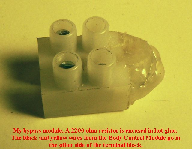

    Several things can happen when attempting to perform this modification.
    * one end of the resistor gets connected to the wrong black wire.
    * the resistor gets connected to the wrong ends of the black and yellow wires. It must be connected in such a way as to be connected to the BCM, not the ignition switch.
    * The chosen resistor is the wrong size. I always use a 2200 ohm resistor, whose color code is three red bands. Those without much electronic experience often use a 2.2 ohm resistor. (color code- red, red, black)
    * when doing the modification at the BCM, the technician reads the pins of the connector from the wrong end, causing them to choose pins B7 and A7 instead of A6 and B6.
    Good luck with your troubleshooting.

    What size resistor did you use to bypass the Passlock module? I always use a 2200 ohm resistor, but any value between 1500 and 4000 will work. In some cases you must do a 30 minute relearn procecure, which is also mentioned at....
    www.bergerweb.net/PasslockFix.
    To read the value of a resistor, hold it so you can read the bands from left to right. The first band is the one nearest to one end of the resistor.
    The first band is the first number.
    The second band is the second number
    the third band is the number of zeros to add.
    The color codes are as follows:
    Black = 0
    Brown = 1
    Red = 2
    Orange = 3
    Yellow = 4
    Green = 5
    Blue = 6
    Violet = 7
    Grey = 8
    White = 9
    So on a 2200 ohm resistor, the bands will be red - red - red
    On a 3000 ohm resistor, the bands will be orange - black - red.
    A common mistake is to use a 2.2 ohm resistor (red - red- black) instead of a 2.2 K ohm.

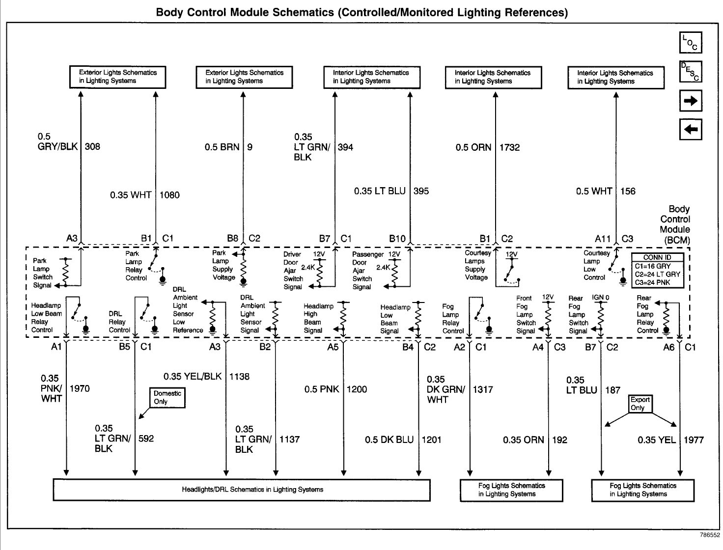

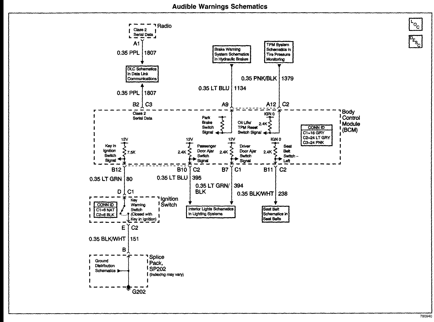

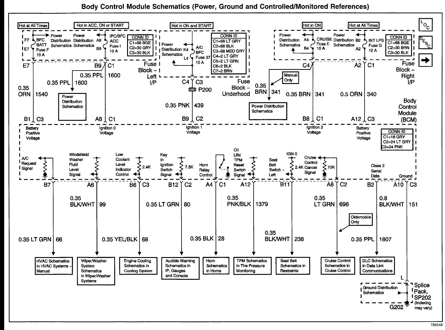

  • lovemygrandamlovemygrandam Member Posts: 330
    It would have helped if you had punctuated this sentence, but from what I read, your dome light, your door locks, your fog lights, and your trunk release don't work. ( I was trying to understand where your "door locks fog lights" would be located. ) OK, back to the point....
    It looks like you have a problem with your Body Control Module, which contains control circuitry for all of the items you are having problems with. You will find the three wiring diagrams for the Body control Module at the following links:
    BCM Schematic 1
    BCM Schematic 2
    BCM Schematic 3
    This should be all you need to troubleshoot all of your problems. The first thing I would do is remove all the connectors from the BCM, Clean them with alcohol, and then re-connect them. If that doesn't help, you probably need a new BCM. The BCM is located behind a kick panel right below your glove box.
