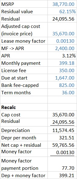

  • cooladecoolade Member Posts: 11
    Hi all, had a ques about the invoice price of a potential demo car lease. Car I'm looking at is a 320i that has approx 2,000 miles on it. Car specs and pricing info per Edmunds are as follows:
    Per dealer lease terms:
    Residual % - 62.15% | Adjusted cap cost (invoice price) - $35,670
    Residual seems about right to me (maybe $200-$300 undervalued), but I'm trying to determine whether the invoice price is reasonable. Edmunds invoice price is $35.7k for new condition. Shouldn't there be a greater discount since this is a demo car with 2,000 miles?
    Thanks in advance for any advice!
  • konacougkonacoug Member Posts: 196
    Coolade: this is a very bad deal, I would expect to see this on a new car, not a used Demo. Right now, you should be able to get a new 2014 320i for close to 2k under invoice with the $2000 option credit. I wouldn't even consider this vehicle, unless they drop the selling price to $4000 below invoice.
    What area of the country are you in, I could point you in the direction of a reputable dealer in your area? Also, you should consider the sport line, it is an excellent value for the 320i model.
    Lastly, what is the money factor, should be .00130 and your payment?
    edited August 2014
    konacoung thanks for the advice. I am located in NYC but this quote is actually from a dealer in Scranton, PA, who I worked with on my previous lease . If you could refer me to a dealer anywhere around / in between the NYC to Scranton areas, would be much appreciated! Do you know if they waive disposal fees and remaining payments on current BMW lease even if you enter into a new lease through a different dealership (my current 2-yr lease ends in December, but I wonder if any deals on 2014 models will still be available then)?
    Here are the deal specs:
    Dealer said $399 monthly payment includes the NY sales tax (8.75%). He mentioned a rebate of $1,000 was included in the price. FYI this is for the AWD model.
    Thanks so much!
    edited August 2014
    Also, konacoung, how did you arrive at $4k below invoice as being a fair price (I recognize $2k of this $4k comprises the $2k option credit)? Just wondering so I can come back to dealer with a reasonable argument.
    Regarding the residual, the dealer quoted residual of 62.15%. I read somewhere in this thread that residual for 2014 320i 36/12k should be 64.00%, less approx $0.20 / mile. Therefore, would it be fair for me to propose a residual of 63.00% (calculated as follows: $38,770 x 64.00% = $24,813 - $0.20 x 2,000 miles = $24,413 or 63.00%)?

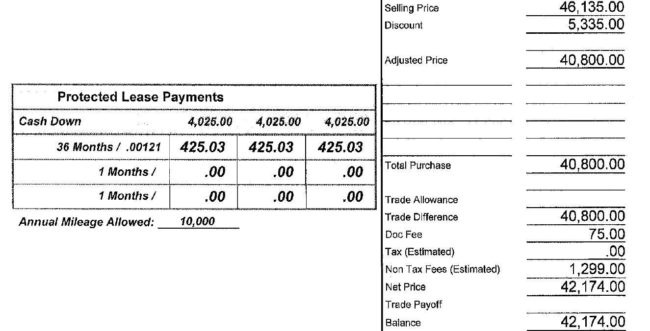

  • cocococococo Member Posts: 17
    Thank you so much for your detailed explanation and input, konacoug!
    This is a new car, shipped recently from California to the port of Oregon. I'm quite hesitant about putting down the $2000 deposit at the moment.
    I got another offer from BMW Portland. A 328i xdrive with premium package and driver assistance package, MSRP $46,135, selling price $40,800. I'm planning to put no down payment and 36/10K. Unfortunately, the MF is .00121 even after 7 MSFs. They calculated a monthly lease of $425.03 (no sales tax in Oregon). But using the edmunds lease calculator, I got $398, not sure where went wrong.
    I was told that $4025 is due at signing including 7 MSFs (450 * 7 = 3150), first payment (425), license, title and registration.
    I also saw a non-tax fee of $1299. Does this include $925 acquisition fee? When do I pay it?

  • MichaellMichaell Moderator Posts: 266,378
    I'm attaching the lease payments from the dealer. Could you please let me know how they got a monthly lease of $425.03? May I insist on using the base MF with 7 MSFs, i.e., .00081? Is there any way to lower the monthly lease? And lastly, is this a good deal? I'm thinking to negotiate the selling price even more since the MF is so high. Many thanks!
    https://us.v-cdn.net/5021145/uploads/editor/0e/vkz73wwq3um0.jpg
    I'm also getting $398/mo using your numbers. What is the $1299 of "non tax fees"? They are adding this into the sales price to get a net cap cost of $42,174 - this takes my calculations to $438.08/mo.
