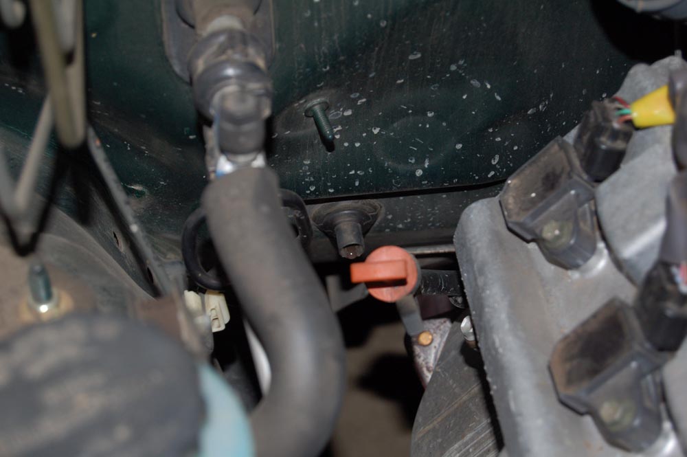

    You can check to see if your Sequoia has the A/C TSB installed by looking in the engine compartment and comparing it to this:
    http://www.kevinhawk.com/toytsb.jpg

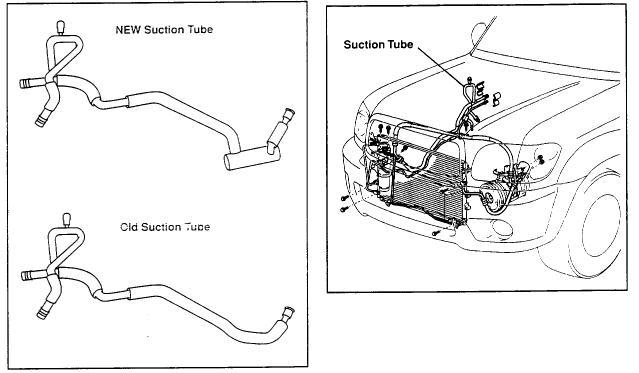

    my dealer said if I'm worry about the ac problem, they can order the whole AC unit from toyota and replace it for me under warranty. should i do that? my ac is working fine so far.
    any advice will be greatly appreciated
  • raddboy41raddboy41 Member Posts: 249
    It's not the WHOLE unit that has the problem. It's just the suction tube that needs replacing unless the compressor has already imploded. Have you checked your suction tube design to see if it's up to date?
  • lupgalupga Member Posts: 8
    i checked with toyota customer service, according to their info. the new suction tube has only been replaced at the beginning of 02. mine 02 bought in august 01. so it's unlikely the new tube. also i checked it with the picture, it doesn't like the new suction tube.
    dealer called last week, my order has come in. i told them i may wait for another year to see what happen before i decide whether or not to replace it. they said it's up to me, but they also mentioned the compressor in general is also a problem, but it hadn't got to TSB yet.
    is replacing the suction tube a big deal? if not, i might just ask them to replace just the tube. what should i do? i live in California, it's not hot like desert, but i hate to know it may break down when i go on a long trip in some hot weather, or it happens after my 3/3600 miles warranty.
