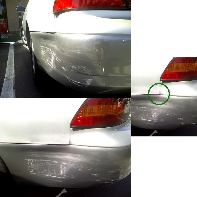

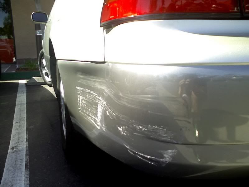

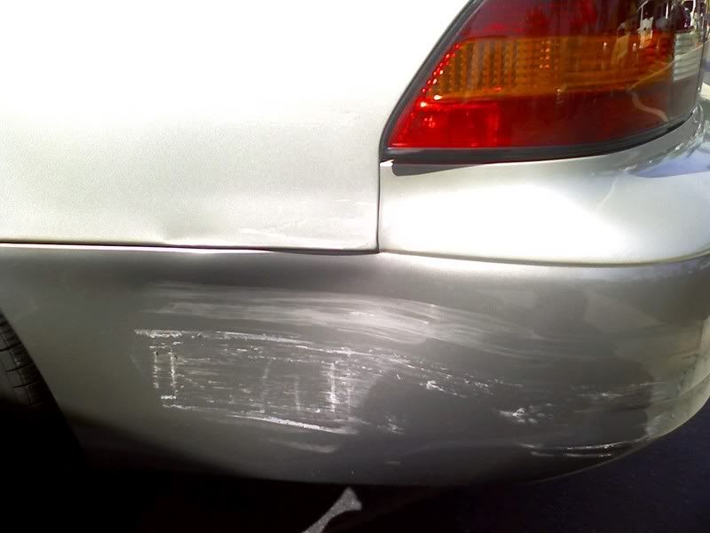

  • shanecbx3shanecbx3 Member Posts: 2
    Well…my brother and I were backing out of a parking space in a busy parking lot, when we backed into the Lexus (good thing it wasn’t one of the Bentleys, Lamborghini's, etc. that are regularly near there)
    Back to the story, the damage was to his back left side/corner of the bumper. The side panel was pushed in and had a lot of our cars paint on it. I am kinda concerned about the top left panel (circled in green in the picture), it looks like the paint is chipping away. The back tail light had a very small crack in it and was a slightly scraped on the bottom edge. I got down and looked under the car and from what I could tell there no damage to the car frame.
    So is there anyone with body shop experience that could give me a figure for the damage. My friends dad may be able to help get the dent out and order parts for cheap... Does anything needa be replaced?
    I appreciate everyones help and input...
    Here are some photos on photobucket:
    http://i51.photobucket.com/albums/f365/shanecbx3/PIC-0081.jpg
    http://i51.photobucket.com/albums/f365/shanecbx3/PIC-0080.jpg
    http://i51.photobucket.com/albums/f365/shanecbx3/PIC-00810.jpg

    Some more advice about parts and paint from dealerships. You should really watch parts departments. Ive been around dealerships besically my entire life and they are all about money. Now Im not saying they are out to get you but I have known some parts guys to give the wrong paint knowing the customer will mess it up more than it was, hoping they'll bring the car in to be fixed at the dealership shop. Also, you've got to know that most parts people arent especially smart. We work with parts departments everyday, from BMW to Mercedes, Lexus and Porsche, every parts department has a trend. Usually there is only 1 guy who is good at his job, the others are normally stock boys posing as parts guys. So just so you know, be aware and check all the numbers. Good Luck. Joshua
    I think you'll have to re-skin the bumper. It doesn't look repairable, or at least not a repair that the owner will want to look at very closely.
    So you have to price out the bumper skin + painting it plus repair of that upper panel + tail light lens.
    I'm just guessing here but I'd say to do a nice job on a nice car it would be $500 to paint and match the skin and install it + parts price of the skin ($300? $500?) plus refinish the upper panel and blend the paint ($600)....so you're probably looking at $1,500--$2,000 damage.
    Yeah, dealers and such get people to come in and patch up and repaint bumpers, but it's not the best quality and as an owner of a nice shiny car, I wouldn't let you fix my car that way.
    You may wish to claim this on your insurance. Usually if your claim is over $1,500, it's worth making a claim vs. the rise in rates you'll get.
