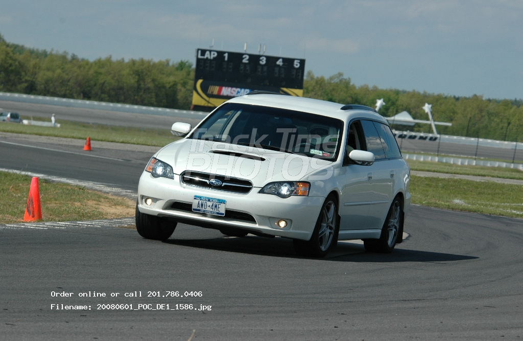

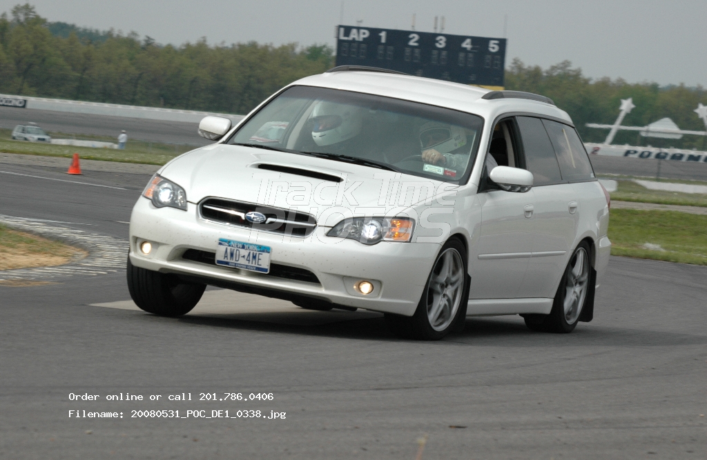

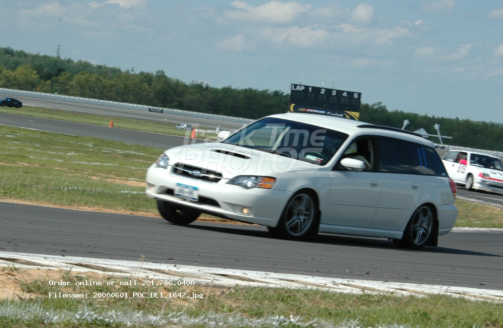

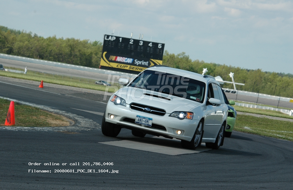

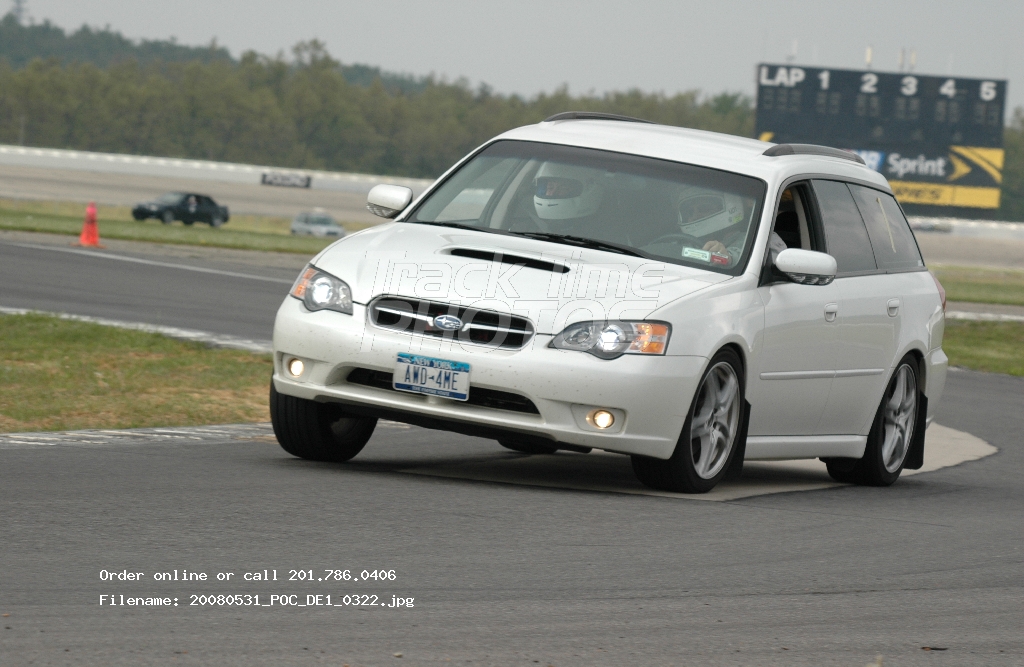

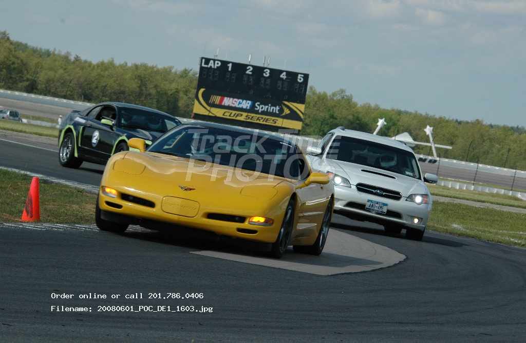

  • bat1161bat1161 Member Posts: 1,784
    Looks like a lot of fun, especially considering the company on the track. Were you driving or instructing?
    Mark
    I was going to comment on the body roll, but it looks like the Corvette isn't doing any better in that regard.
    Are you on stock springs, mike?
    I was doing timing and scoring, and took my car out for a few sessions. The pictures exagerate the lean, cause they are on an angle, but you can see how much it's leaning due to the wheel tuck. It does lean a lot but it is on stock springs. I may do sway bars if I continue to run it on-track, and once I settle on a "new" car, then that will dictate if I get streetable coilovers for it as well. I was amazed how well it did, the biggest issue I had was that after I got down around 1/2 tank of gas, it started to get fuel starve on the banking. As I would go up onto the NASCAR banking from the infield road course portion of Pocono North, the fuel would get carried to the driver's side of the tank, the pickup is on the passenger side which was the lower and inside side of the turn.
    I was quite suprised that the Hawk HPs pads held up extremely well even during 2 30-min sessions that I ran back to back. They didn't fade on me at all and didn't leave me really begging for more braking, although more is always better, for a nearly stock (except for the tires and SPT Catback) the car performed outstanding.
    -mike
