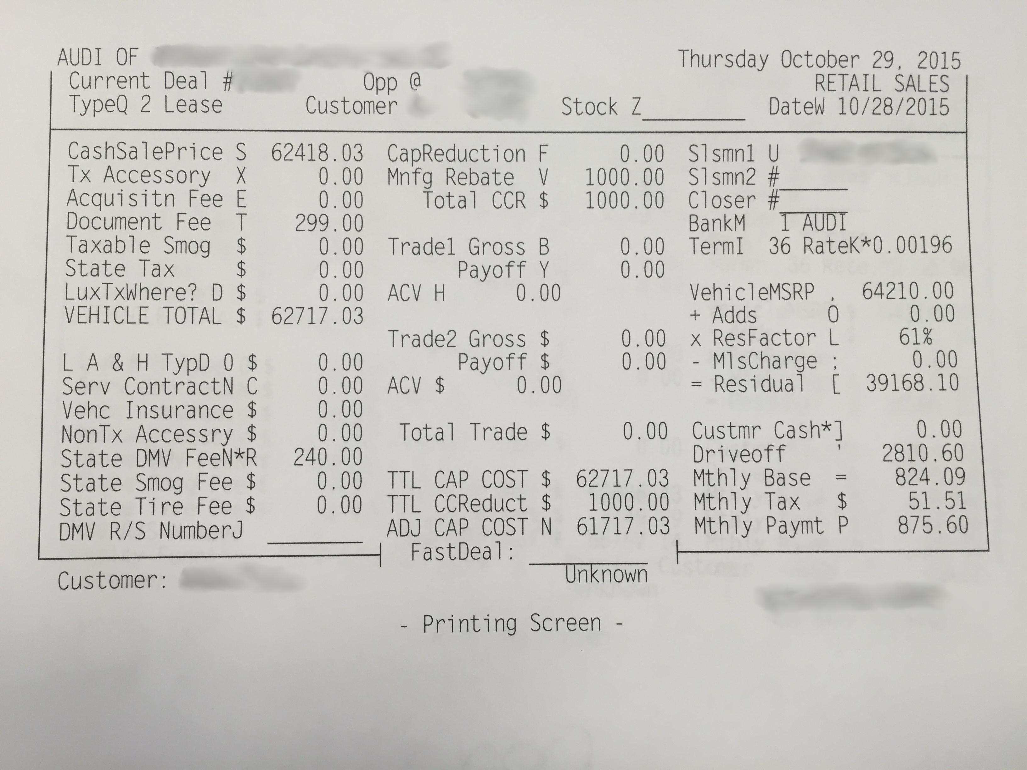

  • MichaellMichaell Moderator Posts: 267,827
    Attached is the deal sheet or whatever you call it
    I have the Friend and Family certificate, which states the price of "Invoice + $300" then subtract any incentives, which is $1000 Audi Loyalty for me
    36 months / 10k miles
    61% residual
    .00196 money factor - aka 4.704%
    6.25% local Massachusetts sales tax
    MSRP is $64210
    $0 down
    Payments are WAY too high in my opinion
    Thoughts?
    As noted by my co-host, the MF is marked up from the base of .00138; the marked up MF is adding about $60/mo to your payment.
    Might be time to reach out to other Audi dealers ... only takes one to meet your terms.

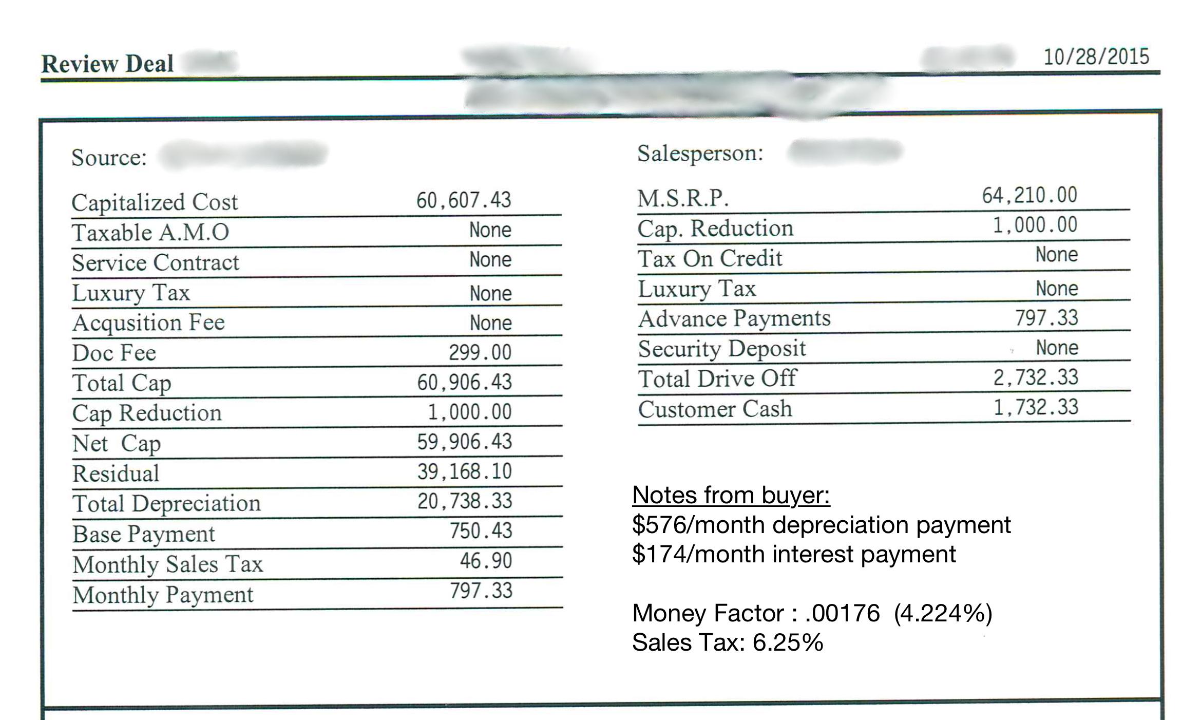

  • mikewembleymikewembley Member Posts: 10
    Numbers listed above were slightly off on the 6% discount - Audi Care is still included at no cost
    Here is the new sheet at MF .00176 - "best and final"
    Have you reached out to another Audi dealer? Getting them to compete amongst themselves will get you the best deal.
    I wouldn't sign any deal with an inflated MF .. but, that's just me.
