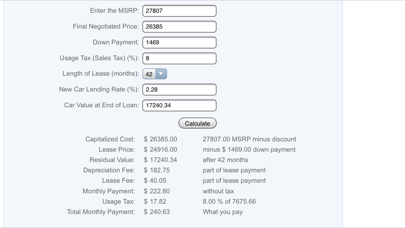

  • carsrconfusingcarsrconfusing Member Posts: 2
    edited November 2016
    I'm helping my mom with a 2017 Forester lease because her current 2014 Forester lease is ending this month. I used this forum to learn to calculate exact lease payments but my numbers are off from what both local dealerships - and way off from one of the highest volume dealerships in the country in upstate NY - are quoting me. One of the dealerships would give her what amounts to $969 in lease equity for her current Forester.
    2017 Premium w/ All-Weather Package
    42 months/12k miles
    MSRP: $27,807
    Negotiated price: $26,385
    Down payment: $969 equity + $500 out of pocket = $1,469
    Residual: .62
    MF: .00095
    Tax: 8%
    I came up with $240.63. Even if I added in the $595 acquisition fee and $177.50 DMV fees that'd only be $259.02 (I'm not sure if those last two fees are taxable.)
    My lowest quote from a dealer was $284.48.
    Thanks for the help and feedback!
    42 months/12k miles
    MSRP: $27,807
    Residual: .62
    MF: .00095
    Tax: 8%
    I confirm the 62% and .00095 lease numbers.
    Ask the dealer what the adjusted cap cost is - that should explain the difference in the payments.
    BTW, with those numbers, I get $280/mo with tax included.
    This calculator came up with the same (a penny off from rounding.) Any idea where I'm going wrong? Should the the acquisition/DMW fees be added to cap cost figure in all of the calculations?
