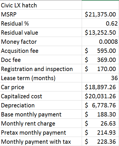

    How about a LX hatch, CVT in MA, 36 months, 12k miles/year?

    .00080 and 62%
    $350 lease cash

    I was quoted $229/month to sign and drive. This is based on acquisition fees ("bank and doc") of $964, registration and inspection at $170.
    MSRP is assumed to be $21375 per Edmunds, and the dealer gave me a price of $18897, which appears to be below invoice.
    The math appears to check out and they gave me the same money factor and residual as shown here.
    How did they get below invoice? Is that the "lease cash"? I assumed that is just a discount.
    I agree with the math, as well.
    Don't worry about 'below' or 'above' invoice; the dealer wouldn't agree to the deal if they weren't making money somewhere.
