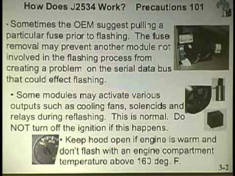

    The technology is way out of control. I don't envy you guys who have to keep up with it. I'm 70 years old and have always done all my own repair but it's getting tougher with every model year. Tonight I was watching a youtube video on J2534. https://www.youtube.com/watch?v=wKG9KWp8czQ
    Don't think I will be getting into that! Just give me a 1967 Impala and I'll be set for life. 8^]
