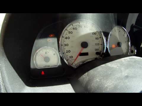

    Hello, I have a 2006 Saturn Vue 3.5 and it decided to crank but not start, my gas gauge is saying empty and have my check engine light, gas light, and one that has a wrench through the car. Code reader will not connect, I checked all fuses and tried listening for the fuel pump but having trouble hearing if it buzzes or not. I primed by turning the key on and off, keeping the ignition on for 30 minutes. I disconnected the negative on battery and put it back. I can't check the fuel filter because I was told it's in the tank. I finally got it towed to a mechanic. I really wished I could have figured this out myself. Has anyone had an issue like this?
    I know this is a few months old, but... I did not have this same problem, but saw a Youtube video about the exact same thing you mention. In the video, the issue is caused by a bad Body Control Module (BCM). The video walks through some diagnostics, and says the problem is common. https://www.youtube.com/watch?v=t9SygNt2UP8
