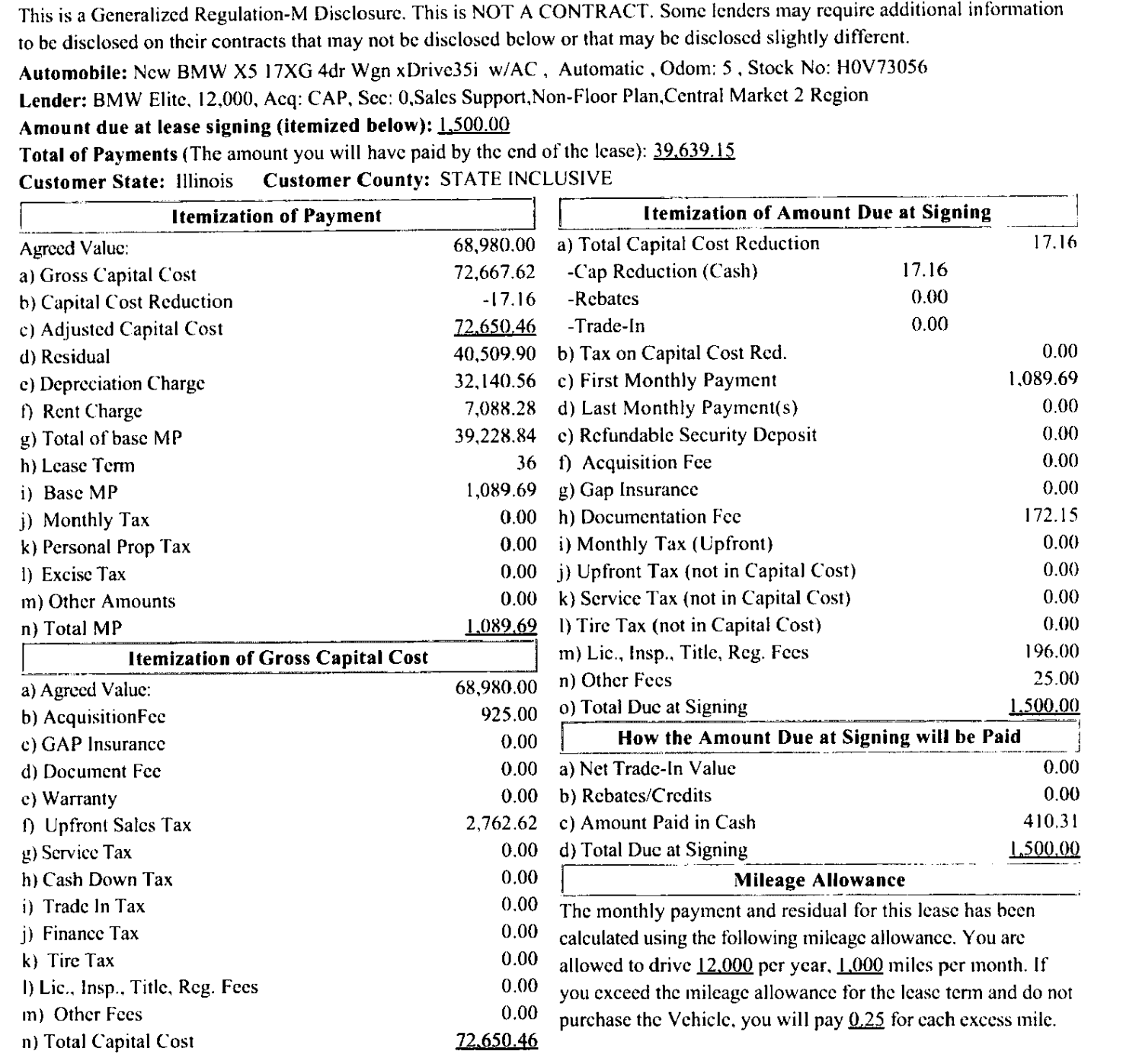

  • cmyk32cmyk32 Member Posts: 14
    I'm new to leasing, does the math look right on this/is this a good deal? Seems high?
    2017 X5 xDrive35i
    MSRP - $71,070
    Selling price - $67,480
    Sales tax in lake county IL - $2,762.62
    Tag fee - $196
    Doc fee - $172.15
    Elec filing - $25
    Cap cost - $72,650.46
    Residual - $40,509.90
    MF - .00170
    With $2,500 down - monthly payment = $1,060/month
    With $5,000 down - monthly payment = $983/month

  • kyfdxkyfdx Moderator Posts: 267,780
    2017 X5 xDrive35i
    MSRP - $71,070
    Tag fee - $196
    Doc fee - $172.15
    Elec filing - $25
    MF - .00170
    Those numbers don't add up to $72,650, unless you left something out.
    The base MF is .00134

    Here's the full breakdown...
    cmyk32 said:
    cmyk32 said:

    So, the price of the car is $2500 more than in your first post. Did you notice that?
    And, the .00170 MF is marked up from .00134, adding $40/mo. to the payment.

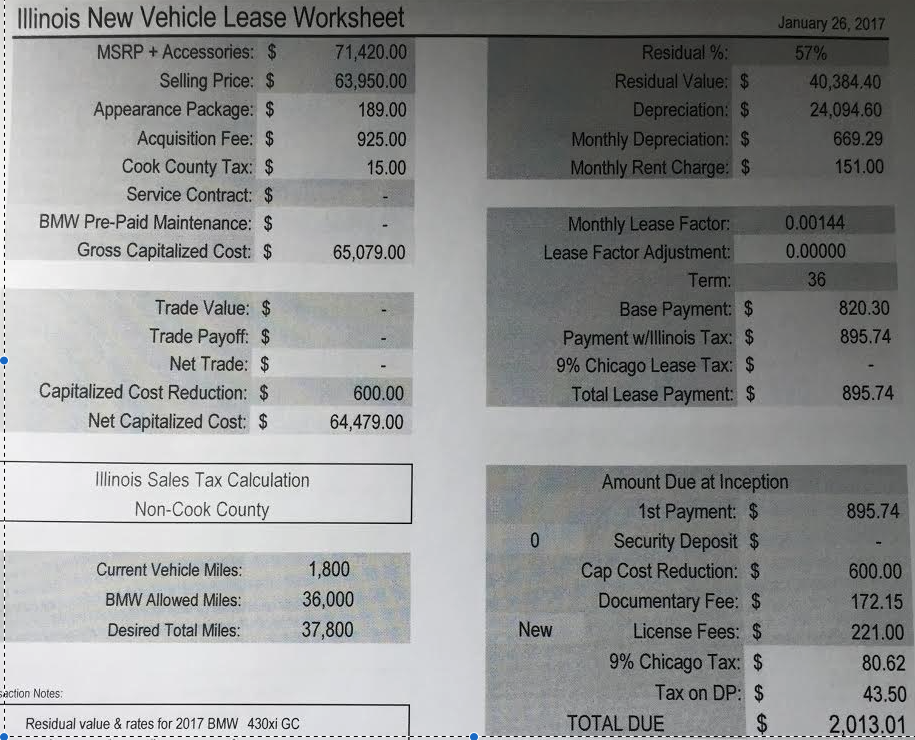

  • MichaellMichaell Moderator Posts: 264,994
    cmyk32 said:
    How does all this information look, it's for a 2017 X5 xdrive 35i with 1,800 miles on it. It looks like the residual is correct but they're slightly marking up the MF. I'm not sure about the other details and if it's enough of a discount off MSRP for the mileage.
    I show .00134 and 57% for 36/12 on the X5.
    The math on the worksheet is correct. The MF bump is adding $10/mo to the payment.
