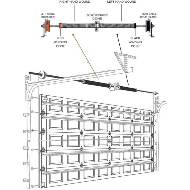

    I have had one spring break, but mine is the torsion bar above the header. There is a spring on each side.
    I never saw that type of installation before. Do you have a door that’s very heavy? It would be interesting to see if the door would still work if the torsion spring broke while the two side springs were still good.
    No side springs. It's as shown in imidazol97's diagram. Door is not very heavy. When one breaks it's hard to open. I don't know if the other one interferes or not. I just call the guy.
    They are very careful when they replace one. They stick a rod in a hole and turn the spring so many times. They put a chalk mark on it and wind it up. I don't know all the details. They always come and look at it and go back to the shop to get what they need. I assume there are different strength springs. I imagine if it let loose it would do a job on you.
    One of my axial springs broke last summer. Luckily the Cruze was outside when it happened. My door is insulated double layer aluminum. Too heavy to lift with onlyl one spring assisting. The guy replacing the spring(s) did it without ever lifting the door, even with my Malibu only a few inches from the door. AND he talked on the phone to another tech that he apparently was mentoring or helping with some other kind of installation. The same company did the replacement of our 72 inch swinging patio doors.
    Also lucky is that our 2.5 car garage has a regular access door to the side of the garage, so tech could go in and out easily as he worked. Otherwise he would have had to tramp through the house to get to the garage.
    I replaced both springs. It's like bending a paper clip repeatedly to break it when these spring wind tight and relax. If one broke, the other will break as soon as the tech leaves the driveway if I only replaced one spring! Lol.

    That looks like the standard installation for a torsion spring operated garage door.
    I have a double door too and the spring on mine is about 3 inches in diameter and the pipe is about 1 inch in diameter.
    There are different strength springs and the colored line on the spring designates the spring strength.
    When the spring breaks the pipe contains the spring. Which as I understand it is better than relying on a 1/8 inch wire rope that passes through the center of the springs on the side mounted spring design.
    The disadvantage of the torsion spring design is when the spring breaks. Most people ain’t gonna mess with that sucker whereas side springs are a piece of cake to replace.

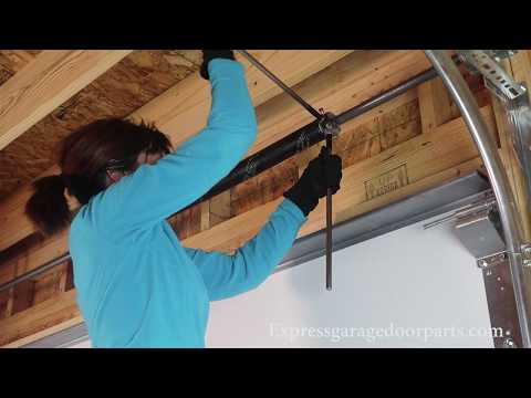

  • imidazol97imidazol97 Member Posts: 27,745
    What I'd like is the opener that sits on the end of the torsion rod on the wall adjacent to the door tracks.
    I put on torsion springs two changes ago. It's very simple when you consider the laws of physics. I had two
    steel rods that fit into the holes on the flanges at the end of each spring. You loosen the nut that holds it to the rod. You start twisting the spring using one steel rod and then the other. Always be careful not to stand in front of where the steel rod would be thrown if you slipped in your process. Very simple. LOL
    BTW the last two times I called "THE GUY" and let him do it. That was about 5 or7 years ago and then last summer.
    It's so easy, your wife can do it.
    https://www.youtube.com/watch?v=2udM-E2kxNA
    It's much nicer to watch than to do it. :)
