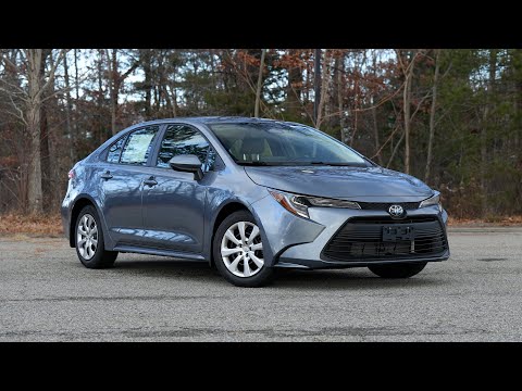

    I'm going to try to cautiously disagree with that. At the starting price in the US of c. $24k the Corolla is probably the best car on the market at that price. Toyota's engines are impressive. Even Corolla's have both port and direct injection, which is more expensive, and something not found on any other car outside of Toyota at that price. Corolla's now have peppy and efficient engines that have unparalleled reliability and longevity. On average I don't think even Honda's last as long.
    The design of the body is also rare at this point in that there's impressive rear visibility in a Corolla, and better than found in a Civic or the small Korean cars or the Mazda3.
    Inside they are plain, but all the materials are solid and long-lasting. Their touchscreen system for maps and so on is intuitive.
    A Toyota is a car I'd feel confident about buying without an extended warranty, and I don't even feel that way about Hondas any more.
    The Corolla hybrid is also a great value at $26k, although by the time you get to that price I'd spend 4k more to get the Camry LE, which is a step up in size, comfort, quality, safety, and power.
    A problem with Toyotas is that they are so popular they can't keep up with demand, and so prices are high. Even a Corolla is in a sense a premium vehicle when it comes to quality and longevity, and so it commands a higher price than, say, a loaded up Hyundai Elantra.

    The Corolla engine makes 139 HP.
    Toyota's turbo engines are total underperformers, power and fuel mileage, and have lots of other problems.
  • benjaminhbenjaminh Member Posts: 6,946
    edited September 2025
    The standard Corolla engine was upgraded a year or so ago to the 2.0 liter dynamic force engine, which has 169 horsepower. It's referenced at about 4:30 in this review. It's not quick, but neither is the standard Civic LX 2.0. Starting at 17:50 this reviewer merges onto a freeway and gets up to 75+.
    https://www.youtube.com/watch?v=bCDvnVbH5GE&t=952s
