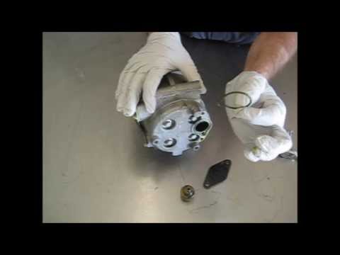

    Good evening fellow Saturn VUE owners. I figured I would come back here to share some promising news for those like me who suffer from no a/c at idle or below 2,000 rpm. It appears a member over at SaturnFans.com has found a solution to address the issue. There is a scroll compressor control valve that can be purchased for $35 here http://www.acpartshouse.com/inventory/116597-scroll-compressor-control-valve that addresses the issue. The part is only listed for the 3.5L V6 on the site, but they confirmed it also works on the 2.2 L L4. The replacement is pretty simple. The hardest part is you have to completely evacuate all of the refrigerant from the system before the part can be removed and replaced. You then must recharge the system. Here is a link to the message thread http://www.saturnfans.com/forums/showthread.php?t=191521. Here is another link to a YouTube video discussing this as well https://www.youtube.com/watch?v=uPUHOnei3g8. I hope this is able to help some of you that have been frustrated like me. I have the part on order and plan to replace it next week. Pretty sad that GM/Saturn didn't know of this inexpensive solution to this issue. Instead they are having owners replace the entire compressor and drier assemblies for a lot of money. Good luck!
