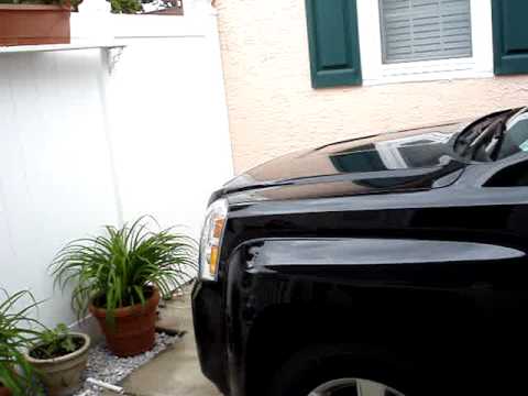

  • arveejayarveejay Member Posts: 9
    My dealer replaced the cam phasers Friday and the noise is back and worse Tuesday.
    I have recorded the noise several times and posted the movies on youtube. My car is going back to the dealer again with 2100 miles on it. I was told they had no idea what to do about it but I did send them a link to the youtube video and they can't deny it is not normal. This engine will not hold together very long making this noise. It sounds like the pistons are trying to change holes.
    edited June 2011
    Right now I have 3 customer service people, (Christina,Tricia and Steve), 1 guy at GM (Mike) (supposedly a midwest Rep)with a case number already issued to me, along with my dealer and his 2 mechanics working on it as of now. What more can you do? Do you know someone that actually cares enough to get this thing fixed? Can you convince me not to persue a lemon law buyback? :lemon: That's about where I'm at.
    http://www.youtube.com/watch?v=7jcFCaG7sUU

  • islaguyislaguy Member Posts: 19
    Hi sumr616
    I also have been dealing with the same startup racket in my 2011 Terrain.The Terrain went in for repairs and work was done with the cam phasors,threee days later the racket was back.Car is now again at the dealers and I got a call from them Friday after dropping the car off Thursday that they are waiting on GM.
    ">link titlehttp://www.youtube.com/watch?v=ButvovoM1rc&feature=mfu_in_order&list=UL
    2nd time
    link title
