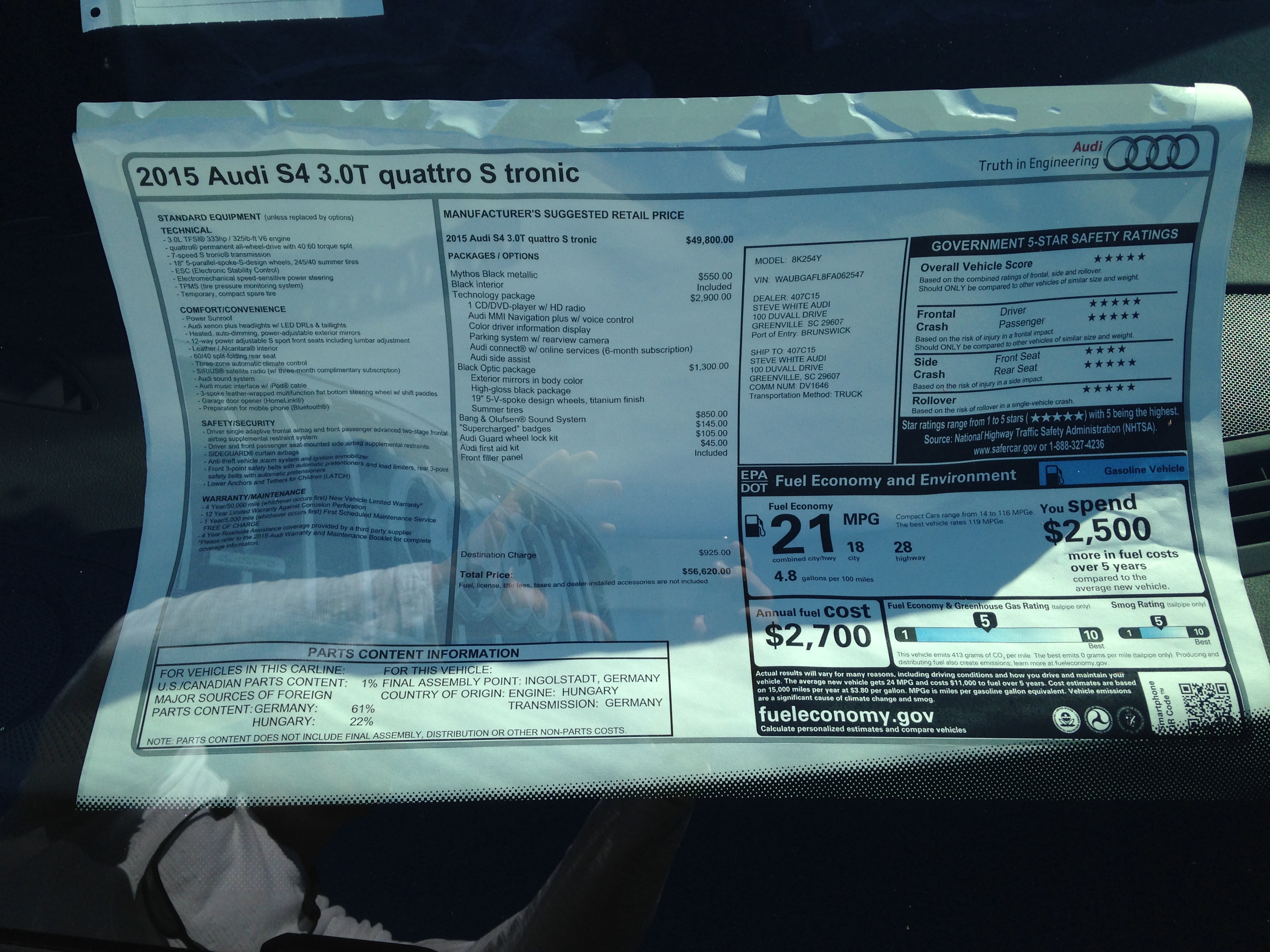

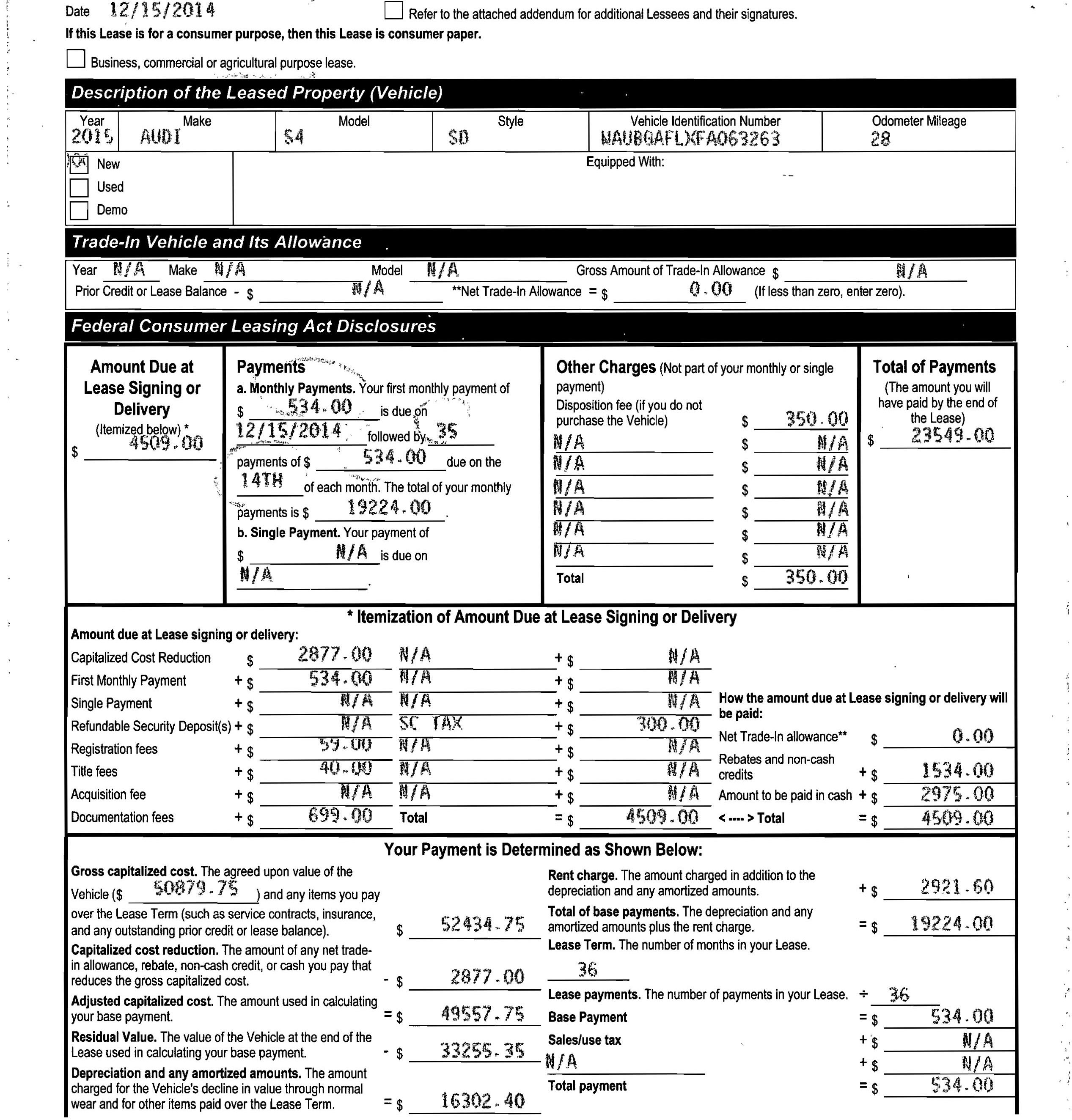

  • asecasec Member Posts: 11
    edited January 2015
    See attached deal for details.
  • kyfdxkyfdx Moderator Posts: 270,787
    edited January 2015
    @asec
    You can see the credit for the rebates on the first document. $1534. $1000 rebate and complimentary 1st payment ($534) from Audi.
    Thanks for posting your documents... very informative.

    asec,
    congrats on your new S4 and great deal. Can you list out the options you have and trim level this is? Also, do you not have sales tax in your state?
    btomasie said:
    asec,
    Sales tax is capped in South Carolina at $300 max. Here is the window sticker.
    asec said:
    btomasie said:
    asec,
    Sales tax is capped in South Carolina at $300 max. Here is the window sticker. MSRP was $56,620
    $534/mo 36 mo/10k miles - 2975 cash at close which includes first months payment and $300 sales tax. Received $1,000 conquest rebate and first months payment rebate of $534.
