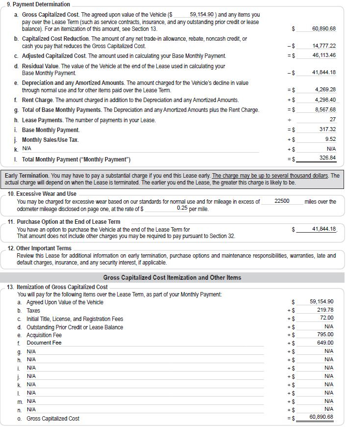

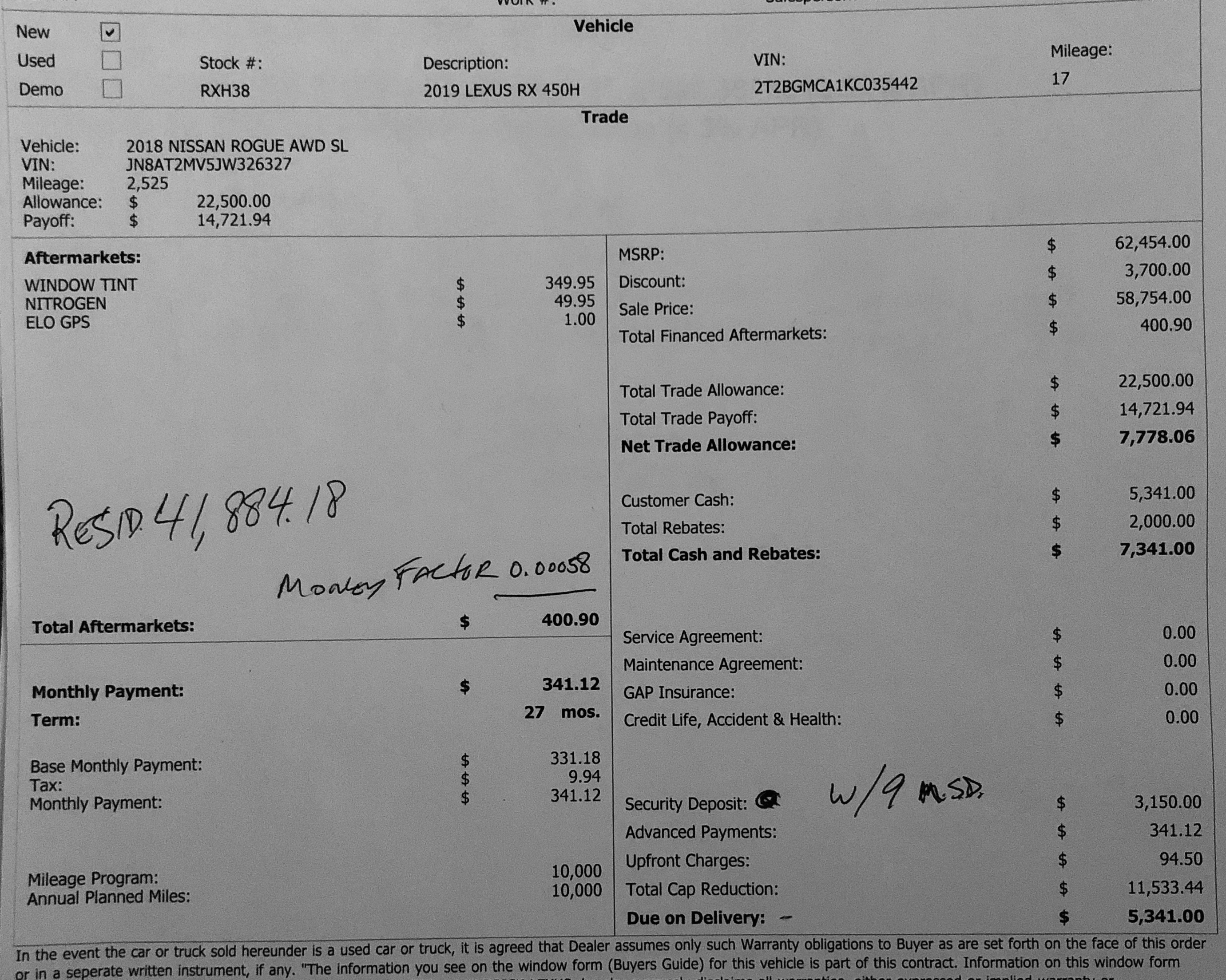

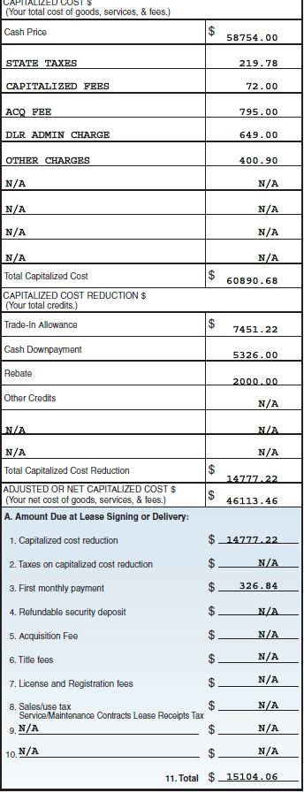

  • uncmikeuncmike Member Posts: 26
    edited February 2019

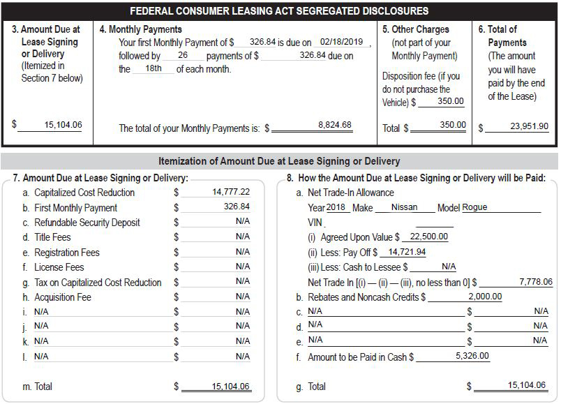

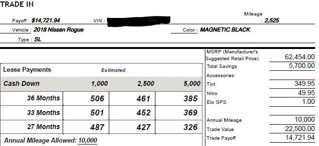

    Hey, I think I worked too hard on negotiating and didn't look closely enough at the actual contract.The quote was off from the actual contract. Posting images and hope they help explain. In short. Bought 18 Nissan Rogue last November, had several issues and went to trade it in to lease a 19 RX450h F-Sport.
    Vehicle: 2019 Lexus RX 450h F-Sport
    Location: Charlotte NC
    Initial MSRP: $62,454
    Residual value: $41,84418 (67%)
    Down payment: $5,326 plus $7,778.06 trade-in
    Money factor: 0.00105
    Monthly: $326
    Asked about the MSDs and was told they wouldn't help and would increase the monthly price.
    This morning, the dealer said he put a cash rebate instead of a lease rebate and asked if I can email the form back to him. Final total savings should have been 7,500, not 5,700. Going back tomorrow in person to see if this lease can be corrected, or did I just get screwed? Any advise would be greatly appreciated as I've been sick to my stomach since last night thinking about it. Thanks!
    Monthly: $326
    If you've taken delivery, there may not be much that can be done.
    If you amortize the $13,000 in up front cash and trade equity over the 27 months, the payment becomes over $800/mo.
    MSDs would absolutely help; if you can restructure the contract to convert the down payment to MSD, you'll save money each month and - most importantly - you'll get that money back at the end of the lease.
    36 months is the sweet spot for Lexus.
    “If you've taken delivery, there may not be much that can be done. If you amortize the $13,000 in up front cash and trade equity over the 27 months, the payment becomes over $800/mo. MSDs would absolutely help; if you can restructure the contract to convert the down payment to MSD, you'll save money each month and - most importantly - you'll get that money back at the end of the lease. 36 months is the sweet spot for Lexus.”
    Thanks so much for the advice. I've been using this forum trying to understand leases more. So I should ask for 36mo lease and have as much of the 13k be MSD? I wasn't sure how to calculate what effect a MSD would have on the payment. Do all of the other figures look correct from the images I posted? Looks like I should have negotiated a better deal off the MSRP.

  • kyfdxkyfdx Moderator Posts: 268,060
    1) The base MF should be .00090, not .00105
    2) It doesn't look like they used .00105, either. If they had, the 27 month rent charge would be approx $2500. Instead, they show $4298. That would impute approx .00180 MF. (massive markup)
    3) We show the FSport with a residual that is 1% higher. 68% in this case, not 67%.
    These three items are a lot more important than whether you used MSDs, or not, or your negotiated discount.
    The difference is $80/mo.
    Go back and ask them what money factor was used. Get ready for a lie, or a big song and dance.
    Man, you guys are amazing. I'll try and use this info. So the salesman was incorrect in stating the MF couldn't be adjusted? He stated it was like the residual and pretty much set. So they aren't required to state the APR or MF anywhere on the contract. I think I would have caught that if I saw it. Can't believe I signed this. Definitely going to take more than a week and research these forums next time.
    uncmike said:
    If it was a purchase with an APR, that would have to be disclosed. Leases are monthly rental contracts, and the rate used to calculate them does not have to be disclosed. But, the rent charge is required to be shown, which is how I spotted the markup.
    Residuals are set by the bank and cannot be altered. We show the residual is 1% higher for the FSport model, though I can't say for sure that our info is solid on that point.
    Money factors can be marked up for extra profit. There is a base money factor (aka buy rate) that is the minimum, but dealers are free to mark it up.
    I was quoted a MF rate of .00105 when the salesman brought me the 'new deal' and I asked him.So they are allowed to mark it up in the final contract? I'll stop blowing up this thread now and let you know what they say.
  • MichaellMichaell Moderator Posts: 265,283
    If you aren't paying attention, dealers will do almost anything to take more money out of your wallet.
    And, we don't mind the questions. Our goal is to try and level the playing field for the customer.
    First leases are almost always an educational experience. We won't talk about mine - it was pretty gruesome.

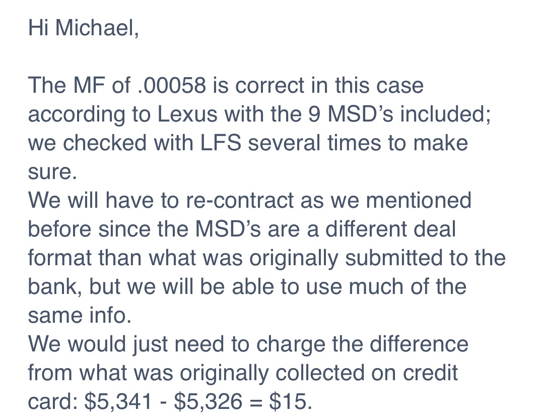

    Thank you Michaell and kyfdx!
    I spent about 3 hours at the dealership. Some of my favorite highlights: "we don't know how to calculate the rent cost. We just put it in the computer and it tells us the number." "The MSDs don't help because you put so much money down on the vehicle." "They only let us apply 8 MSDs because the MF is so low already at .00105." "The MSDs would bring the APR down 1.5%" (I replied that makes 1% down from 2.5% and he told me that is correct.) So kind of all over the place.
    I took notes and recorded the conversation just to make sure I got the details. When I came to the rent charge and MSD questions, things got interesting. Here is the updated printout I was given. They told me to take it home and look it over and let them know what I decide. The official lease hasn't been filed so I should let them know ASAP. I'll be going out of town and won't be back until Monday. I'm assuming the mileage and dates will have to be updated on the lease as well? Do these updated numbers make sense because they still make the monthly payment a little higher. He said this makes the money factor is .00058.

    Here is the response from the dealership regarding the MF, and my original email, is this correct? Would that change the Rent Charge?
    Can you clarify a couple of questions I have? The new document showing 9 MSDs has a money factor of .00058. If each MSD reduces the money factor by .00008, then 9 MSDs total a reduction of .00072. With the resulting money factor being .00058, the original money factor would be .00130 instead of .00105.
    If the money factor after MSDs is .00058 and the beginning money factor is .00105, then the money factor would be .00033.
    Can you explain the difference between the .00130 and .00105?
    Will the lease contract need to be redone with different payment amounts since the customer cash and security deposits are different now? Will Lexus refund the $5,326 that has already been paid and then run the credit card for the new amount?
    If I need to include anyone else in this email that may be more of a help since the money factor was a difficult part to calculate the last time we met, let me know.
    The difference between the base MF of .00105 and the contract MF of .00130 is greed. Dealer is padding the MF for more profit.
    Tell them you won't sign any deal unless it starts out with the base MF.

    This is the new agreement I was sent. Doing the calculations, I end up coming up with approx $300-$400/mo.
    It looks like they almost flipped the old overpriced rent cost with the extreme depreciation amount. I still don't think the .00058 MF is applying here either. Can't remember how to come up with the MF when the Depreciated Value and the Adjusted Cap Cost is known. Here is the new offer and the old one we almost signed.
    NEW
    OLD

    The top one is the new deal, right?
    .00058 is the money factor used.
    This deal is an easy $2750 better than the first one.
    You have a slightly higher payment ($15/mo), but you get $3150 back at lease end.
    They accomplished this by taking most of the markup out of the money factor (still a bump there), and then adding the money factor discount for the MSDs.
    Maybe not the best deal, but you should take it and run.
    Your net cost has dropped from nearly $800/mo, to just over $700/mo.
    It sure isn't the way I would have structured it, but it has turned out okay.
    I'm not sure why they decided to change this for you.... But, it's a good thing.
