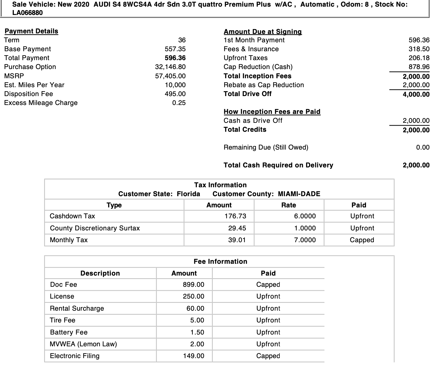

    Remind me never to try to deal with Central Florida Audi dealers again. I thought South Florida is bad. Here was their offer:
    Msrp:$61,590
    Sale price:$56,559
    Then take another $4500 off for rebates
    The lease number with $2145 due at signing is $728 including taxes.
    Residual is 54%
    No way does that fit in with the numbers which the MF should be .00059. Using that the monthly should be about 640. So not only are they inflating the MF, but they aren’t even matching nor mentioning the Costco deal. I let them know the numbers don’t match and their response was “The deal I quoted is the best we can do. Let me know if anything changes on your end.”
    We hear that a lot about Florida
    Also, there is likely a nearly $1000 dealer/doc fee in the deal, as well

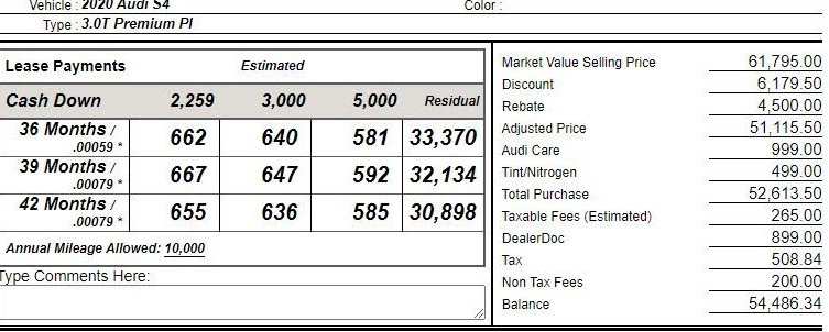

    The dealer and I are getting different numbers. he said he is using the buy rate of .00059 and residual of 55 (audicare). I get 620 post tax 7%. He said he is getting 662, then I reminded him that the tint BS was to be paid upfront and then he said 638, then I reminded him the residual is 55 with Audi Care and he said 628 is the correct amount. Normally I would walk, but with inventory so low, I want to make this work https://leasehackr.com/calculator?make=Audi&miles=10000&msd=0&msrp=61795&sales_price=56616&months=36&mf=.00059&dp=0&dealer_fee=899&acq_fee=895&taxed_inc=4500&untaxed_inc=0&rebate=0&resP=55&reg_fee=465&sales_tax=7&demo_mileage=0&memo=&monthlyTax_radio=true
    Ask him to show you a screenshot of the deal on the computer, or an actual lease sheet workup.
    You can clear it up in two seconds.

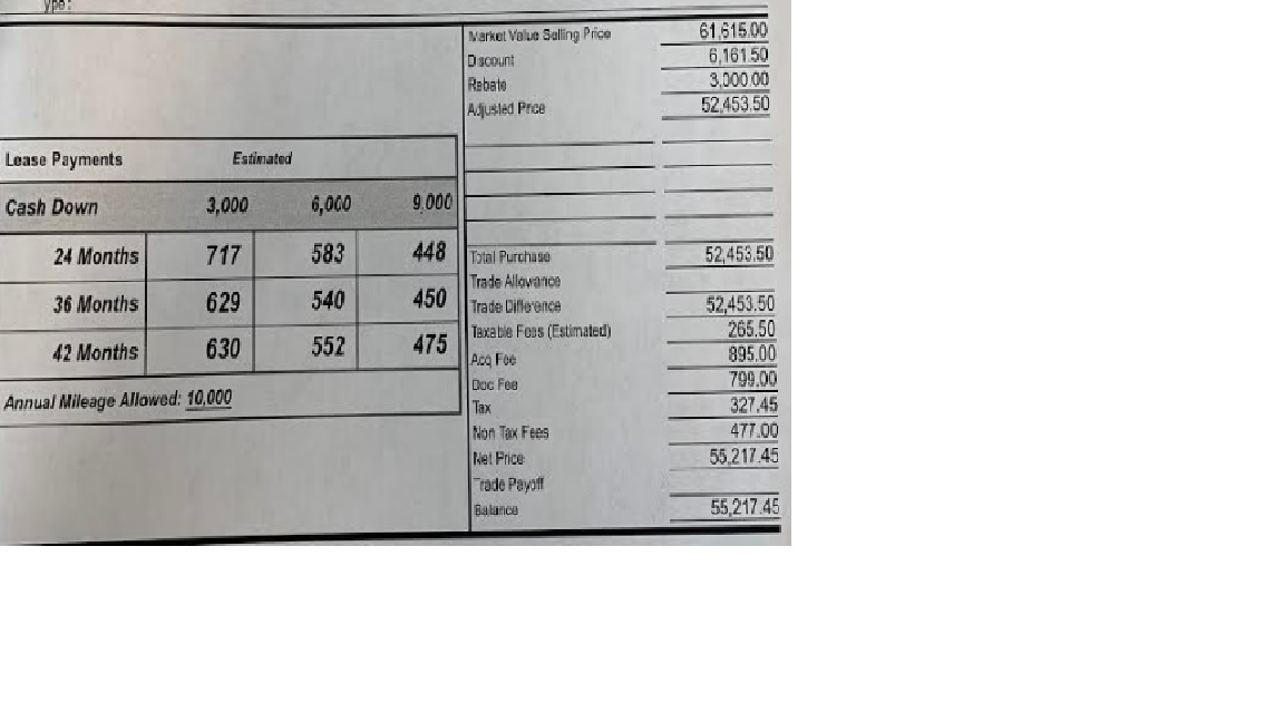

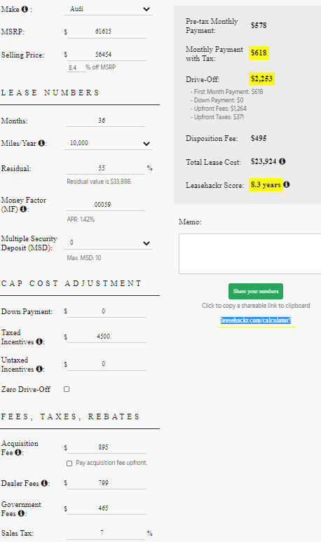

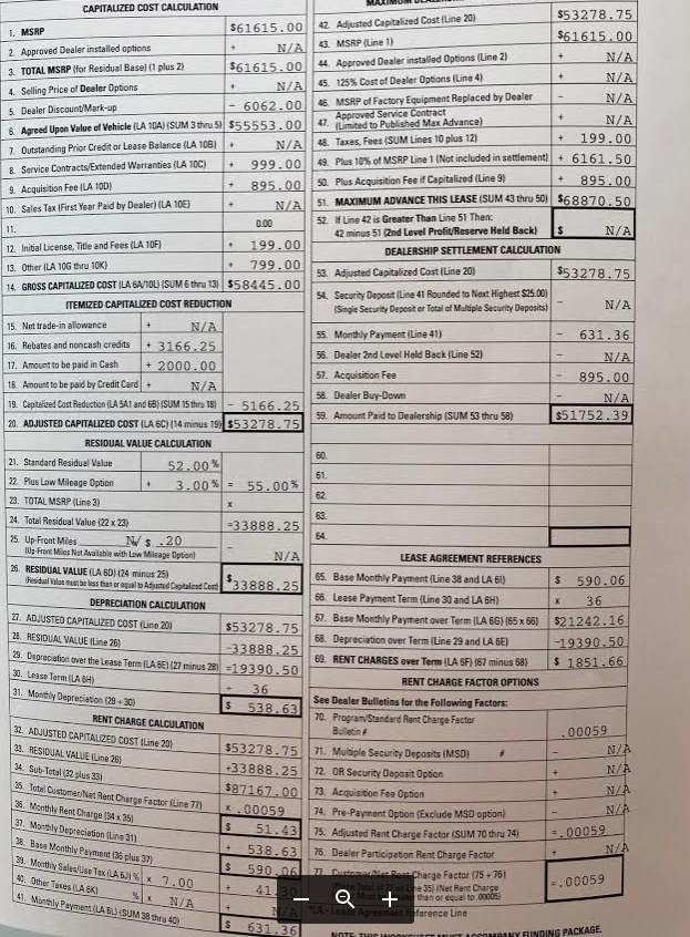

    Here is the lease worksheet of an offer for a premium plus s4. I am getting 618 post tax on lease hacker and they are getting 631 post tax. I will post both to someone can maybe see where the mistake is. I should be getting 4500 in rebates.
    The dealer's calculation is exact, using the Adjusted CAP cost they calculate.
    @southnuma What I don't see on the dealer's sheet is the amount of the rebate ($4500) and a reconciliation of that number with the $3166.25 entered on Line 16.
    $4500
    -$631.36 1st payment
    -$361.64 upfront tax on CAP reduction
    = $3507.
    Not sure where the other $340 went to..
    As all of the fees are part of the Gross CAP.
    Also, not sure why you entered $465 of Government fees into LH calculator. I only see the $199.
    I wasn't too concerned with government fee, more of the monthly non inception costs. So their calculations look good, and leasehkr doesn't assume the correct Adjusted Cap Cost?
    $4500
    = $3507.
    I don't know what leasehackr does. But, it appears you are putting up $2000, and your calculator has you putting up $2253 Due at Signing?
    I would ask the dealer to account for the $6500 Due at Signing ($4500 rebate +$2000 cash)
