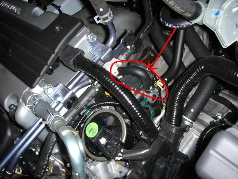

    Ive recently been hearing some sort of rattling noise when im sitting in my 2007 Accord I4 SE sedan idling. Ive checked this noise with my friend's I4 SE sedan and the noise doesn't seem to be as loud as mine. I went to the dealer and asked about this problem and this was the part that the dealer's mechanic said was the source of the problem and that it was normal.
    However the sound coming from this part is considerably louder in my car than in my friend's car, to the point where I am afraid that there is something wrong with this part in MY car.
  • fnamowiczfnamowicz Member Posts: 196

  • benderofbowsbenderofbows Member Posts: 542
    I think I may be hearing the same "rattling" noise. It is more like something is lightly tapping a little more frequently than once per second. I don't hear it when I'm at a drive through and have the window down... it's not loud enough to be heard echoing back off the walls. I only hear it with the radio off, and all the windows up.
    What is that peice? That looks like a rubber hose...

  • ricardoheadricardohead Member Posts: 48
    "However the sound coming from this part is considerably louder in my car than in my friend's car, to the point where I am afraid that there is something wrong with this part in MY car."
    Not 100% sure why a sound coming from a little hose would be louder in your car than your friend's, but it should be easy enough to pop off that hose and make sure it is clean inside. It looks to be in clean and good shape but could also be the hose has a pinhole or something, because other than a hole or a crack a hose is not going to make a whole lot of noise.
    If you're not talking about the hose, but the part underneath it, please identify the part. What did your dealer say it is? If you don't know, can you check it out for a part number and post it here? Then maybe we can advise. Also please describe the noise a little.
  • savegassavegas Member Posts: 26
    The part that I am talking about is that hose. The dealer's mechanic told me to feel the hose while the engine was idling. The hose was in a matter of speaking, beating. This beating matched exactly the frequency of the tapping noise that I heard in the cabin of my car. This tapping sound can only be heard when you are idling in a quiet area with all the windows rolled up.
    The hose has the following number printed on top: AGE-ECO-6X03.

    Thanks savegas. I can't even find that part number online to see what it is associated with so it is a bit hard to be helpful with you. That part it is connected to ... you know what it is? Maybe it has a number? Something about the set-up in your pic and this issue reminds me of an issue a GF had with a Honda a few years back. Turned out to be something in a suction device below the hose but nothing major ... the suction was to aid some form of emissions control, but didn't do a whole lot else and was not life threatening so she decided to let it ride (I wanted to dig in further but we were on the skids). The "ECO" in the part number seems to fit that emissions bill, and maybe the unit it is connected to a part that is generating irregular suction at idle which is reverberating thru. Still, if you can get any info on the part below, please post it.
    Thank you, ricardohead.
    I am going to see other dealer this Friday to find out what is going on with this noise. Hopefully, I could meet a more skillful mechanic. Once the problem is corrected, I will post here.
