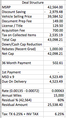

    Thanks for the info! I put together this deal sheet myself in excel, and I wanted to get someones opinion before I went to the dealer. Should I be more aggressive? Is it too aggressive? Fair? Feedback very much appreciated!
  • MichaellMichaell Moderator Posts: 267,761
    MSD amount is the payment rounded up to the next highest $50, or $4950.
    The payment math is correct.
