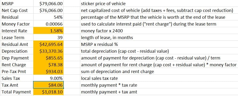

    wisely33 said:
    Thanks for your feedback Michaell. It's a HSE V6. Also, what is the monthly on the sum of the capitalized cost? Not sure what numbers to plug into the formula to get the interest?
    39/15 on the HSE V6 is 54% and .00066.
    Here is a screen shot of my spreadsheet, with your prices and my lease numbers plugged in, assuming the tax rate is 9%.
