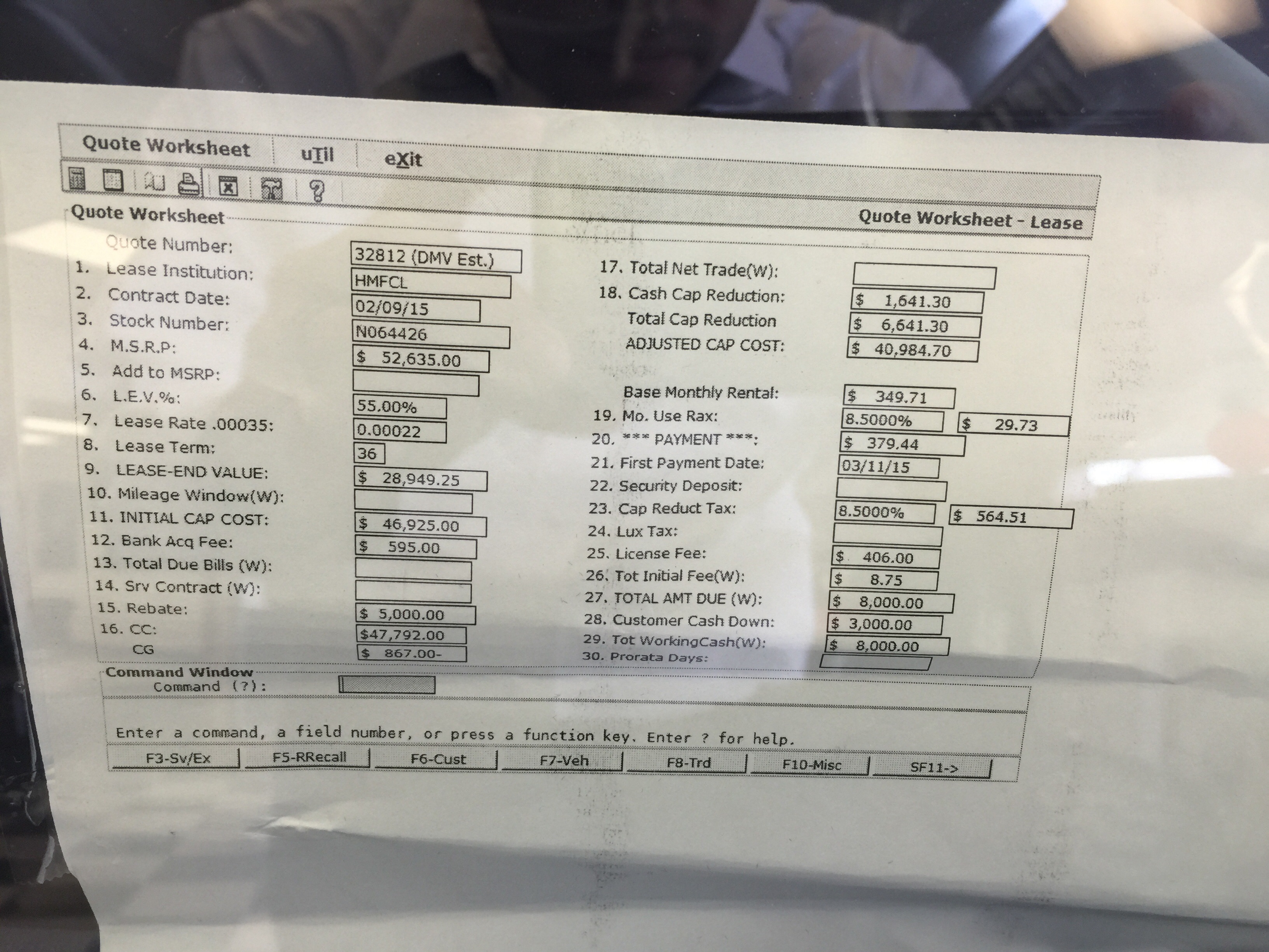

  • jreyes3844jreyes3844 Member Posts: 4
    Can I post a picture or email someone! I took a picture of the lease terms?
  • MichaellMichaell Moderator Posts: 268,603
    You can post a picture here in the forums.
    Does that look right?
    I'm assuming this is for the V8.
    We don't recommend you put any cash down on a lease (the $1641.30) - if the car is stolen or totaled, you lose that money. Not putting the money down increases your pre-tax payment only $45.59 - the $5000 rebate is certainly helping you keep the payment down.
    In fact, you should keep the entire $3000 in your pocket and use part of the $5000 rebate to cover your up front costs - first payment, license ($406) and acquisition fee ($595) - and use the rest as cap cost reduction.
    Re-calculating the numbers, using the same $52,635 as the MSRP and the new adjusted cap cost of $44,240.09 ($47,762 - (5000 - (406 + 8.75 + first payment), I get a pre-tax payment of $448.85; after 8.5% tax, $478.32.
    This is a pretty good payment for a car that stickers at almost $53,000 - you keep the $3K in your pocket.
