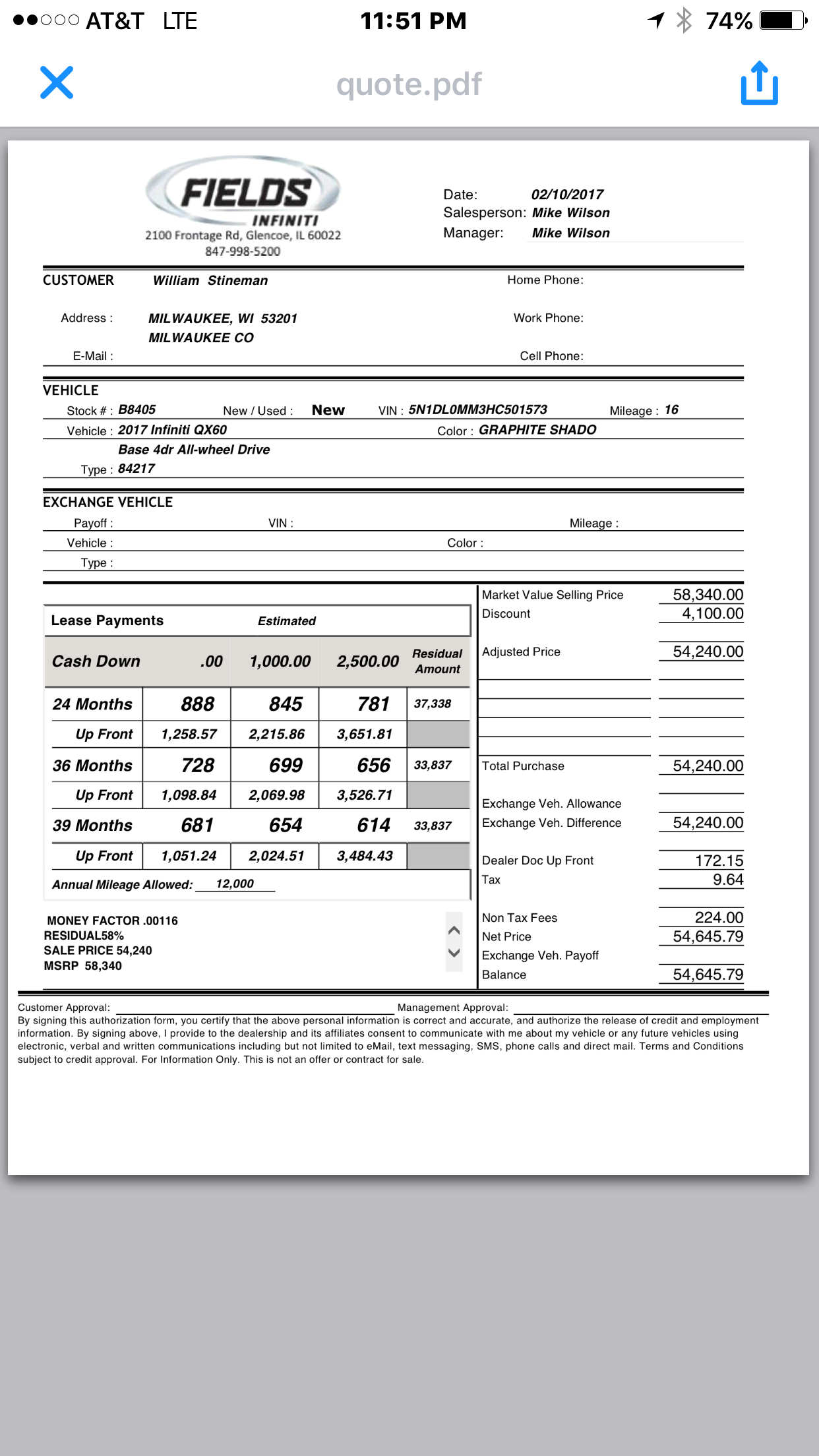

    This is From the 2nd dealer I called    More options and higher Msrp.
    let me know in numbers.  They are using the correct money factor
    Fromyour experience do you think I can get a lower selling price ?
    i can wait until next month if you think money factor will go down?   Appreciate the advice.

    That looks like a purchase quote. Where is the acquisition fee? What is the breakdown of the up front monies?
    While there is some good detail in this information, some important stuff is missing.
    Ask the dealer for the adjusted cap cost and the breakdown of the up front cash. That will help us run the numbers.
