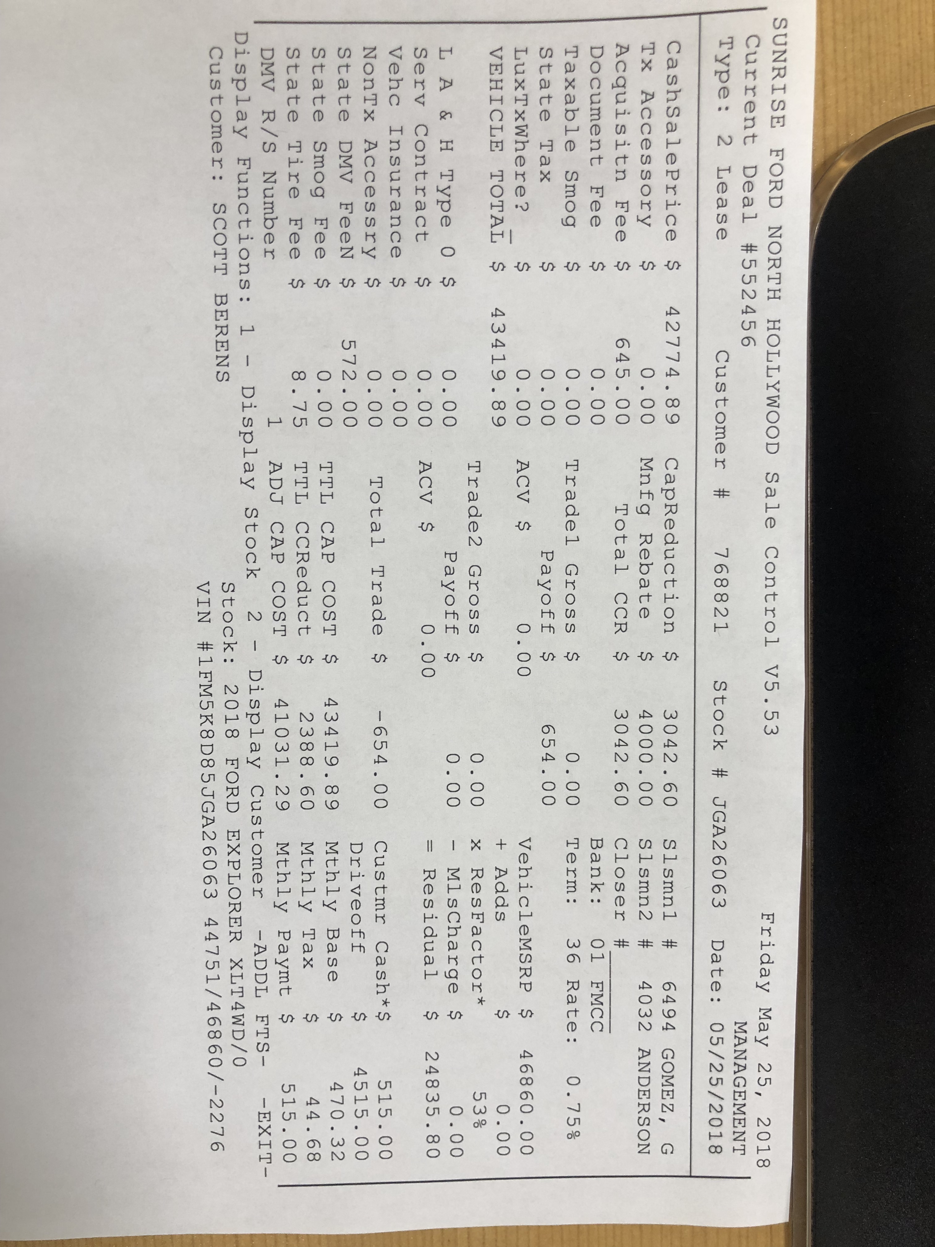

    Appreciate it! Just got an updated quote from the dealer (attached) — mind taking a look? Thank you for this invaluable service you guys are providing.
    This deal includes only paying first months payment of $515 for drive off
    sbz1188 said:
    Pic
    That looks pretty good.
    What is the $654 payoff for?
  • sbz1188sbz1188 Member Posts: 19
    Pic
    That looks pretty good. What is the $654 payoff for?
    Thanks! That is my last two lease payments of $327 that the dealer claims “they are taking care of”
    sbz1188 said:
    sbz1188 said:
    Pic
    yeah... they took care of them by adding the $654 to your deal.
