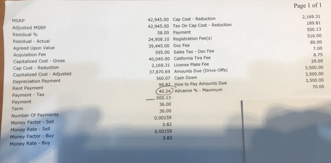

  • rotesssarotesssa Member Posts: 11
    Just got the info. $1,133.88 includes first payment and registration. $2,366.12 would go towards the lease. I'm not familiar with leases so not sure what else should should be included in the drive off amount to make it worth while.
    MSRP is $42,945. Dealer is telling his invoice price is $39,714. It includes an All Weather Package and Suntek.
    Is the dealer's invoice price, your selling price?
    If I take that, add $595 for acquisition fee, deduct $2366 CAP reduction, add $213 for tax on the CAP reduction, for adjusted CAP of $38,156, I get a payment of $446/mo.+tax.
    That's a little ways away from your payment, but I'm estimating some items, based off of your information.
    When spending nearly $40K for a vehicle, it would be good for them to email you a screenshot of the relevant numbers off of their computer. That way, you can see what they see, and ask appropriate questions.
    sorry it took so long. I just received a photo of the lease numbers but haven't had a chance to review. I appreciate any comments.
    I agree with the math on that worksheet.
    I'm guessing the dealer is asking for $3500 down to get to that magical $500/mo payment. Just know that the true cost of the lease is closer to $600/mo, if you amortize that up front cash.

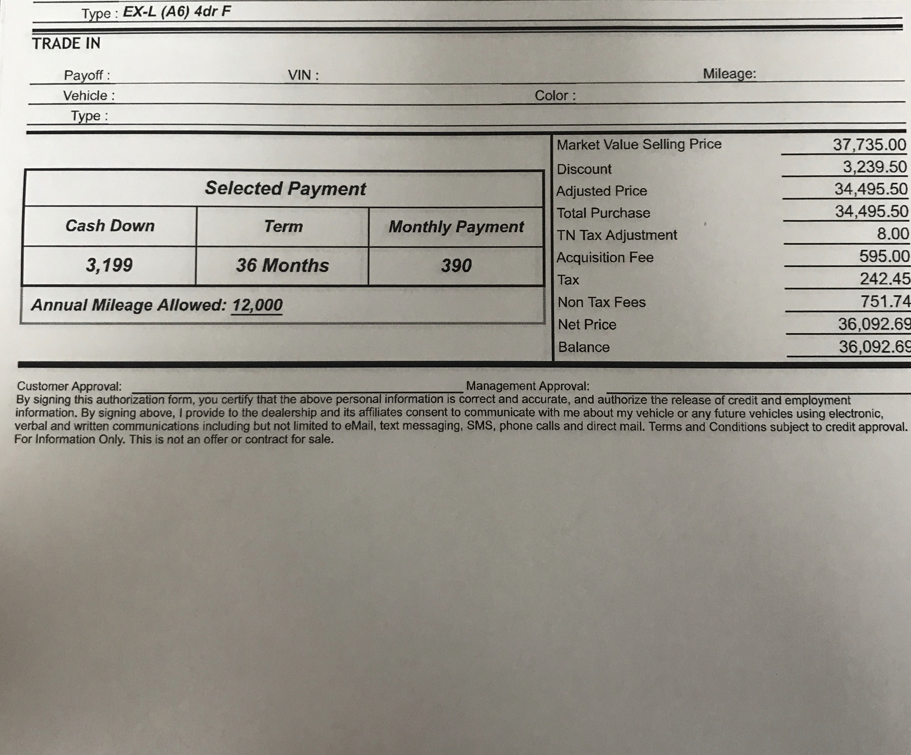

    I’ve never leased and I need assistance with the 2018 EX-L offer/add. Positive equality in my trade equals the $3199 down for what it’s worth. TN tax is 7%. I’m wondering why these figures appear off the mark with these two dealers with 12k and 15k leases. Any assistance is appreciated
    36/15 numbers - .00159 and 59% (FWD) or 60% (AWD).
    We recommend only using the trade equity for the first payment and registration costs. Anything else is at risk if the car is stolen or totaled, and it masks the true cost of the lease.
    If I use the numbers from the last screen shot ($37,795 and $36,091), I get $509/mo with 7% sales tax added in.

    So here's the thing with leasing. There are different variables that the dealer can "play" with.
    The first thing you need to know is to go in an negotiate the best price you can for the car (just as if you were buying the car outright). For a Pilot, you should set your sights on Invoice Minus Incentives.
    The next thing that's important about leasing is the RESIDUAL VALUE (59% for FWD or 60% for AWD in this case). This is set by "the bank" or financing arm and is NOT NEGOTIABLE. This is how much the bank says the car will be worth at the end of the lease.
    The 3rd thing you need to find out is the MONEY FACTOR. This is the interest rate you will pay over the term of your lease. In this case .00159 = 3.82%. Sometimes dealers will "pad" this number to make back end profit. It is sometimes their way of magically lowering your payment. They will quote you (at first) at tier II or Tier III credit and then you qualify for Tier I credit. It is rare that Honda dealers do this, but not unheard of.
    The 4th thing is like the host said: Put as little "down" as possible. If possible, roll your Acquisition Fee & sales Tax into the monthly payment. I'd take your trade equity and stash it away in your bank account and use it to make your 1st X payments or use it toward a vacation.
