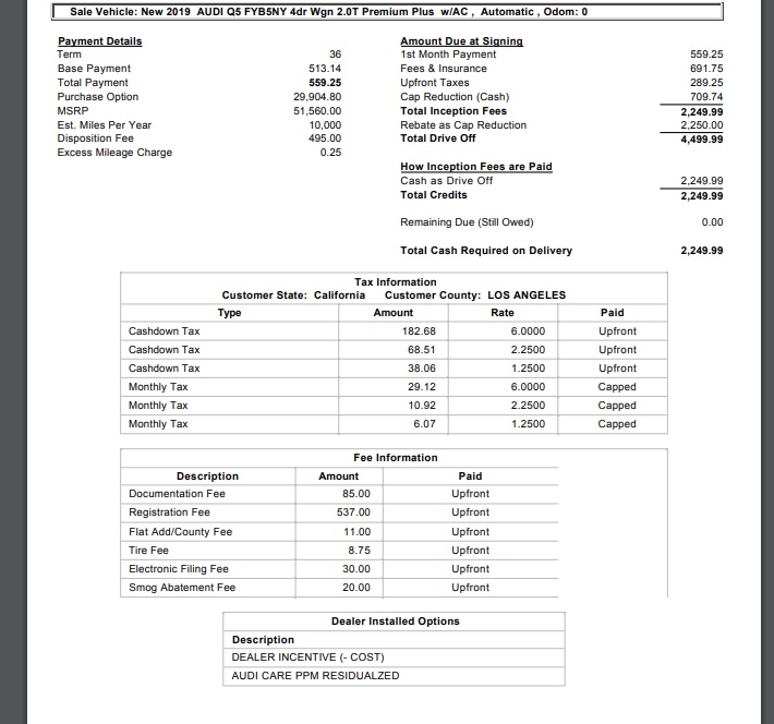

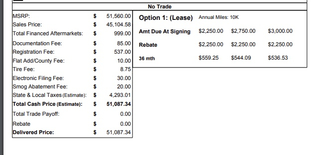

    Does this sound good? This is what I most recently got as a quote after some back and forth:
    MSRP $51,560
    INVOICE $48,960.27
     SELLING PRICE: $45,100
    $2250 DWN
    $559 TX INCLUDED WITH AUDI CARE X 36 MONTHS 10K MILES PER YEAR.
     MF .00163
    RES: 58% $29,904.80
    I get $544/mo with those prices, before tax. What does the $2250 up front cover?
    This is the breakdown
    The numbers on the left are for a purchase, not a lease. Ask the dealer for a copy of the dealer lease worksheet.
    This is what I got when I asked for the lease worksheet.  I can't get the numbers to reconcile using the calculator but maybe I'm miss categorizing the items.  Does it look good to you?
    MSRP $51,560
    INVOICE $48,960.27
    $2250 DWN
     MF .00163
    RES: 58% $29,904.80
    Closer, but that sheet is still missing the adjusted cap cost the dealer used for their quote.
    Keep asking until you're satisfied with the answers.

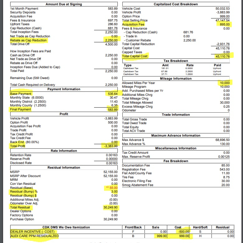

  • BPinLABPinLA Member Posts: 11
    Can someone please review to make sure the money factor, residual value, and rebates look correct? Thanks!!
    2019 P+
    MSRP 52,155
    Sale Price 46,148.54
    Financed Aftermarkets (is this Audicare and do I want to finance this?) 999
    Doc fee 85
    Registration 543
    County fee 10
    Tire 8.75
    Electronic filing 30
    Smog abatement 20
    Disposition fee 495
    Amount Due at Signing
    1st month payment 583.89
    Fees and insurance 697.75
    Upfront taxes 286.60
    Cap reduction cash (what is this?) 681.76
    Total inception fees 2,250
    Rebate as cap reduction 2,250
    Total drive off 4,500
    Cash down from me $2,250
    Monthly 583.89
  • kyfdxkyfdx Moderator Posts: 268,115
    2019 P+
    MSRP 52,155
    Doc fee 85
    Registration 543
    County fee 10
    Tire 8.75
    Smog abatement 20
    Disposition fee 495
    Monthly 583.89
    What term and mileage?
    What is your sales tax rate?
    The aftermarket is the AudiCare. Yes, you want to finance it.
    The $681 CAP reduction is down payment from you. You can eliminate that, but it will raise the payment (which is okay, too)
    I don't see the $895 acquisition fee, or the adjusted CAP cost in your numbers.
    Those would be helpful, to make sure the numbers are all correct.
    Are you sure that is the "sale price", and not the "adjusted CAP cost"?

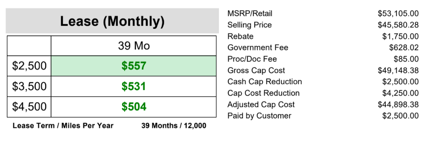

  • RajuMeraNaamRajuMeraNaam Member Posts: 8
    dealer gave me this worksheet, what exactly should i ask? thank you
  • MichaellMichaell Moderator Posts: 265,323
    What ZIP code?
    What trim?
    Is this for 12K per year?

    zip:19047, Premium w/convenience pkg,Pan sunroof, 19" wheels. Pa tax included, 12k miles
    What ZIP code?
    What trim?
    .00163 and 56%
    $500 market allowance
    $1750 leaes credit
    With the prices given, I calculate a payment of $529/mo, before tax.
    Ask the dealer the following:
    1. What cap cost are they using for their payment quote? If higher than the selling price, find out what's been added.
    2. What is covered in the $3000 up front monies? Again, get specifics.

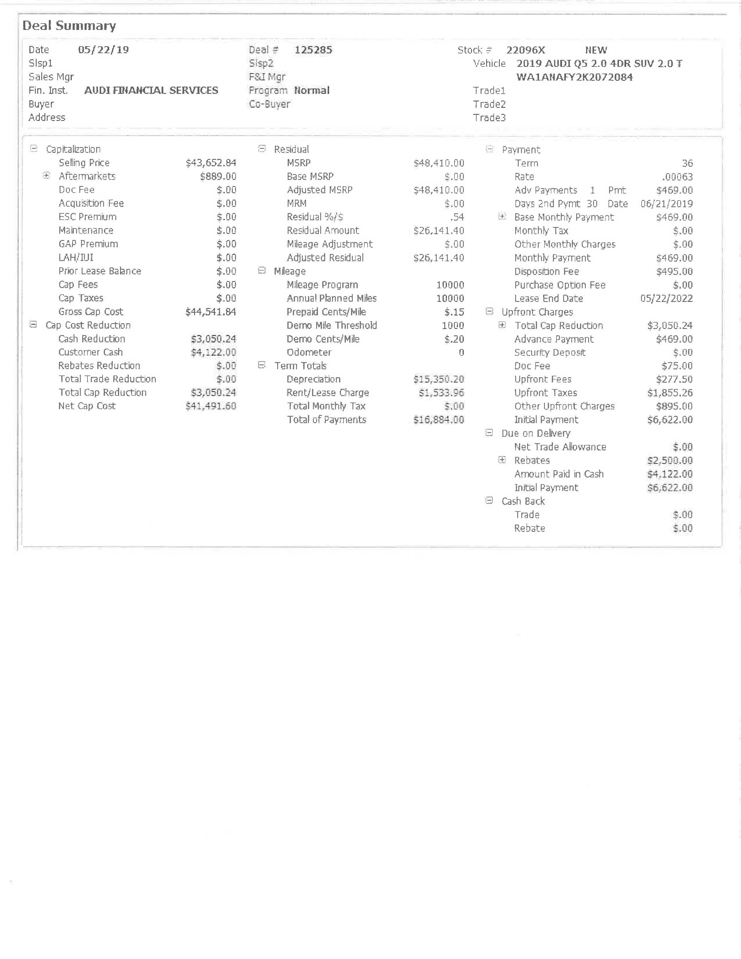

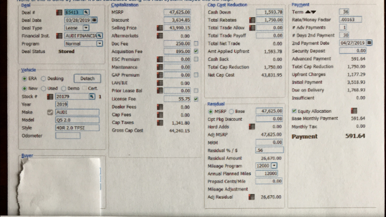

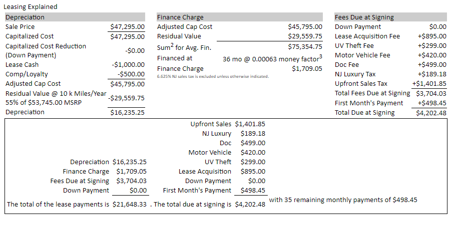

    Hi, so I’m getting this deal here
    does this seem right?
    its so confusing to understand what’s going on
    the 12k miles apparently is a “bug”
    I’m being given 7500
    What is the selling price?
    Adjusted CAP cost?
    Is this NJ or NY?
  • sk1921sk1921 Member Posts: 8
    What is the selling price? Adjusted CAP cost? Is this NJ or NY?
    It’s NJ.
    I don’t know the cap cost but I was told the MF is 00163 and residual value 56%

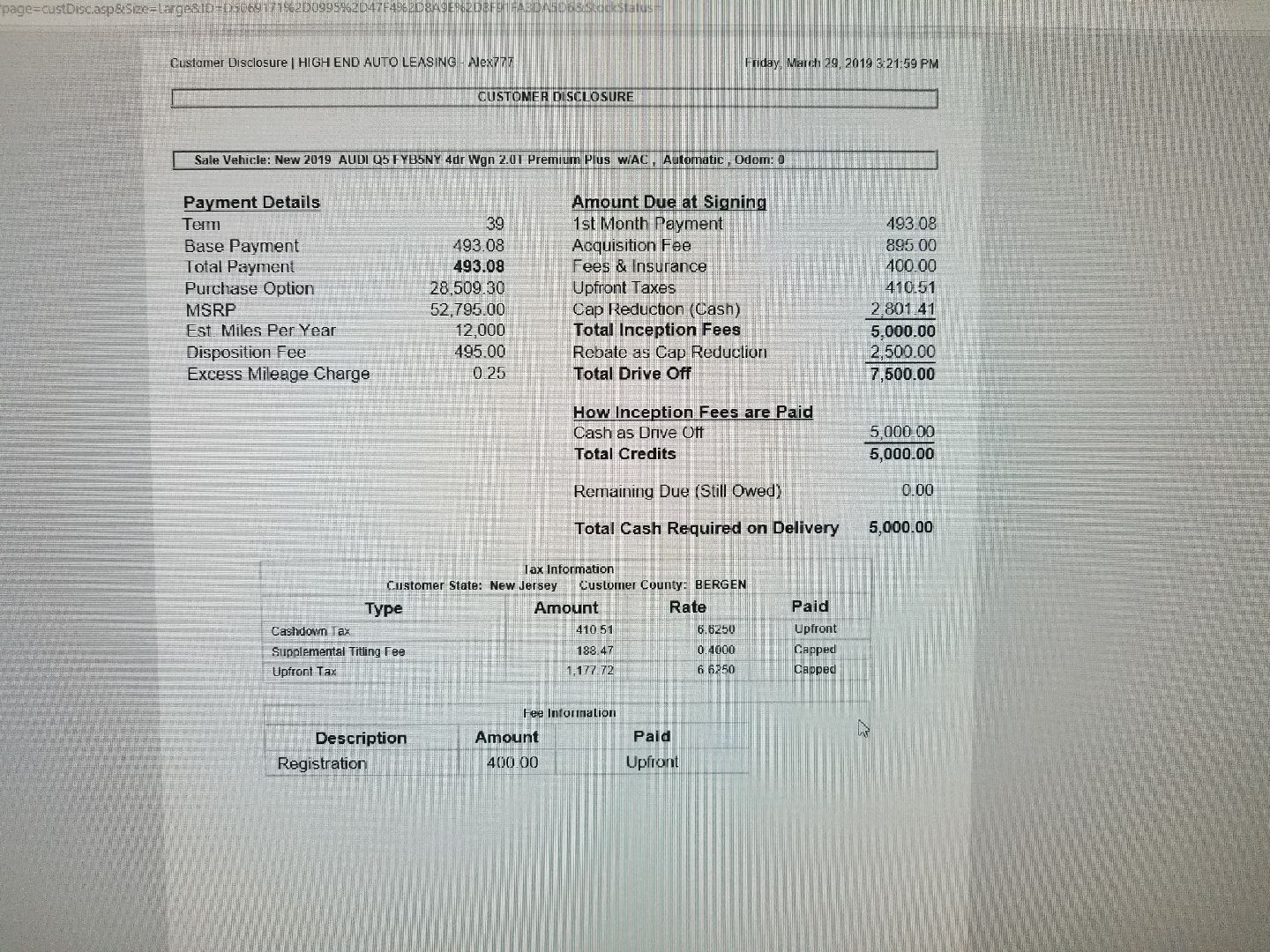

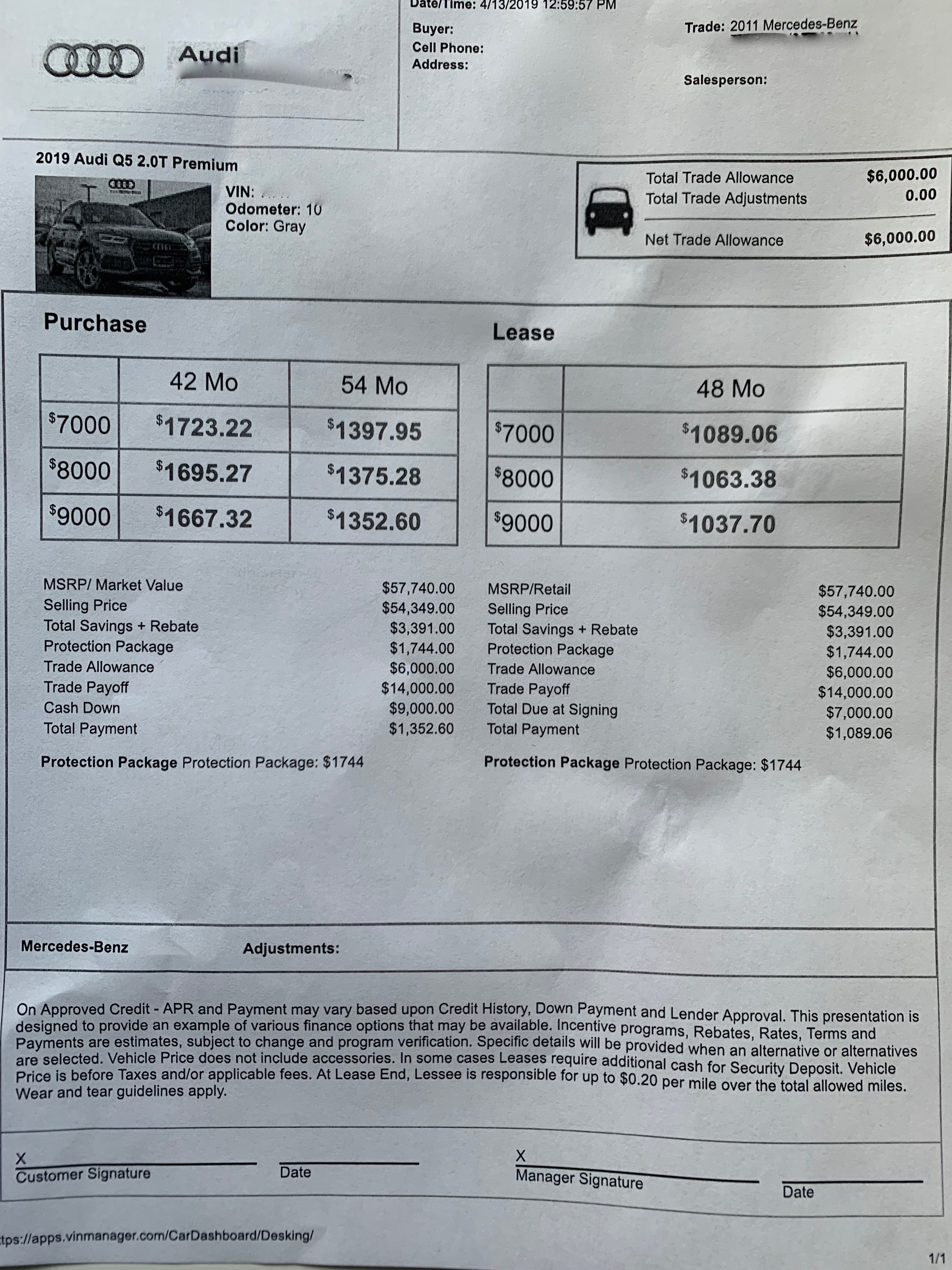

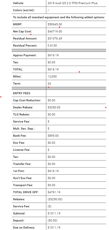

  • aznrayneaznrayne Member Posts: 14
    lease deal offered in ny/nj
    .00163 mf
    54% rv
    39/12
    52,200 msrp incl destination
    47,250 lease price
    1750 lease incentive
    1500 in credit/loyalty
    $983 due at signing
    $612/mo
    this means they only discounted it $1700? what's chance of getting it down to $44k
    .00163 mf
    54% rv
    39/12
    47,250 lease price
    $983 due at signing
    $612/mo
    .00163 MF and 54% residual is correct.
    +$500 dealer marketing allowance
    I think the $47250 is the adjusted CAP cost. (or the sale price before incentives)
    The $3250 in incentives cover upfront costs, more or less (sales tax, acquisition fee, dealer fee)
    We don't have all of the numbers, but I'd put the discount at $4500-$5000, before accounting for incentives

  • Frodog714Frodog714 Member Posts: 11
    Hi, hopefully you can read the worksheet I have attached. Zip is 44685. I would like your opinion/ comments. Seems kind of high to me. Shouldn't they be discounting purchase price more?  Trying to get an aggressive end of month deal. Thanks
    What trim level?
    We don't track pricing; use this link to help with your research:
    Big thanks to @kyfdx and @Michaell for all your help and quick replies!
    Wouldn't have secured this deal without your guidance!
    Posting with the hope this helps others. 2019 P+ Manhattan Grey 36m 10k Audi care in CA
    Congrats! Thanks for the report, and the detailed document.

    .00133 MF and 52% residual
    $1250 lease bonus
    $1500 loyalty
