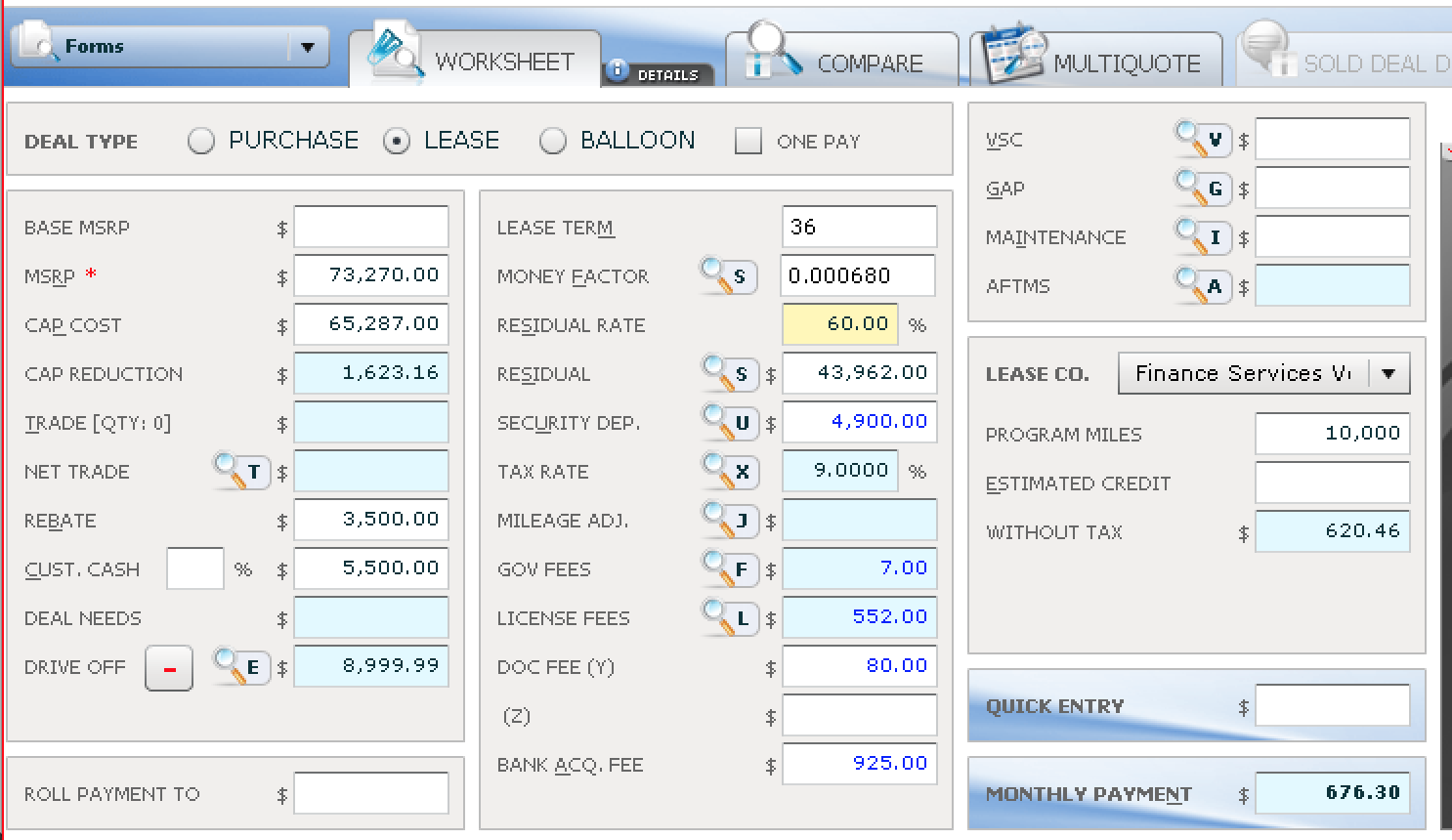

  • tom911tom911 Member Posts: 63
    Thoughts? I'm not understanding the way this is set up. I see my corp MF discount and the 7 MSD's. What's the discount before lease credit and corp discount? Isn't it as simple as subtracting the discount off MSRP and then subtracting the $3500 lease credit and corp discount to get to the Net Cap Cost?? Lease form is confusing to me.
    Thanks in advance.
    X5_1.png 124.7K
    Thanks in advance.
    The cap cost is the discounted price. Subtract the cap reduction from that and you get the same payment the dealer does. My guess is that the cap cost includes the rebate.
    thank you
    tom911 said:
    thank you
    You have $9000 of working cash. Your $5500 plus the $3500 rebate
    Here is where the cash goes:
    $4900 MSDs
    $925 acquisition fee
    $639 other/government fees
    $676.30 1st payment
    That leaves $1859.70 for CAP cost reduction, except the CCR and the upfront acquisition fee are taxed, leaving $1623.16 for actual CAP cost reduction.
    The $65,287 is the selling price (after your corporate discount)
    The net Adjusted cap cost is $63,664 (which I'm surprised isn't listed anywhere.. maybe we aren't seeing the whole screen, or there is another page?)
    The MSDs and the corporate plan make for a really good deal.

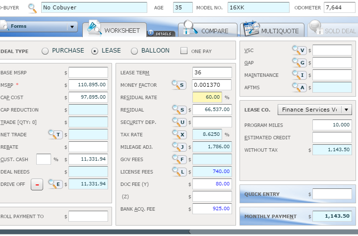

  • nycdompnycdomp Member Posts: 30
    edited August 2016
    Currently working this deal and was wondering if it's a decent deal?
    2016 BMW X5 M
    MSRP 102695
    Selling Price 94580 which incl. acq/bank fee.
    MF .00137
    Residual 60%
    0 Down
    36/10K
    I'm getting $1229.88/month with NYS 8.875% taxes rolled in.
    Edit:
    I'm also seeing a $2000 lease bonus cash on Edmunds.com. I should ask if that was already included, correct?
