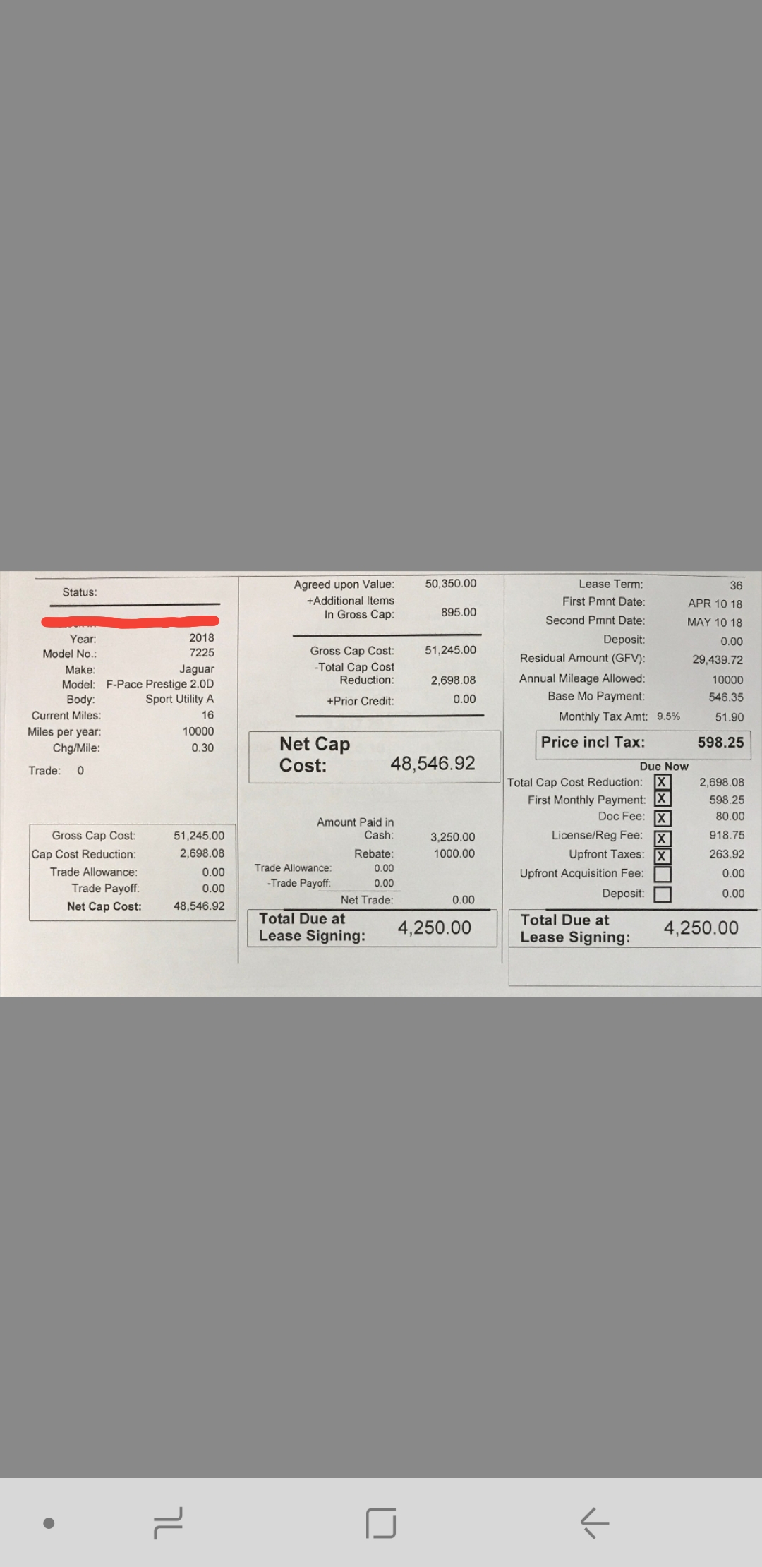

    20D Prestige - .00020 / .00030
  • calibosscaliboss Member Posts: 13
    Ok - thank you. The dealer is saying my MF number is wrong. He's going to send me the deal structure. Thanks so much.
  • MichaellMichaell Moderator Posts: 266,870
    Politely tell them you won't sign a deal where the MF is inflated - they know what the base rate is.
    edited April 2018
  • kyfdxkyfdx Moderator Posts: 269,923
    caliboss said:
    You guys are the best. Thank you for helping me. So here is the deal structure. My D/O is $3250, which is ok if I get the $598 pymt. How would you rate this deal? Thank you!
    .00020 MF and 54% residual
    I get the same number they do.
    $918 seems like a really high license/registration fee..
    I don't know for sure that it's too high... but, I would have expected around $600-$650.
    I know they're trying to get an extra $250-300 from me to put down, but I declined. I just dont know how to determine if this is a good enough deal to move forward. In comparison to the others I received - I think it's ok, and you seem to get the same numbers. But do you think I am getting a good and fair offer on this vehicle? Thank you!
    Sorry, but we don't track pricing.

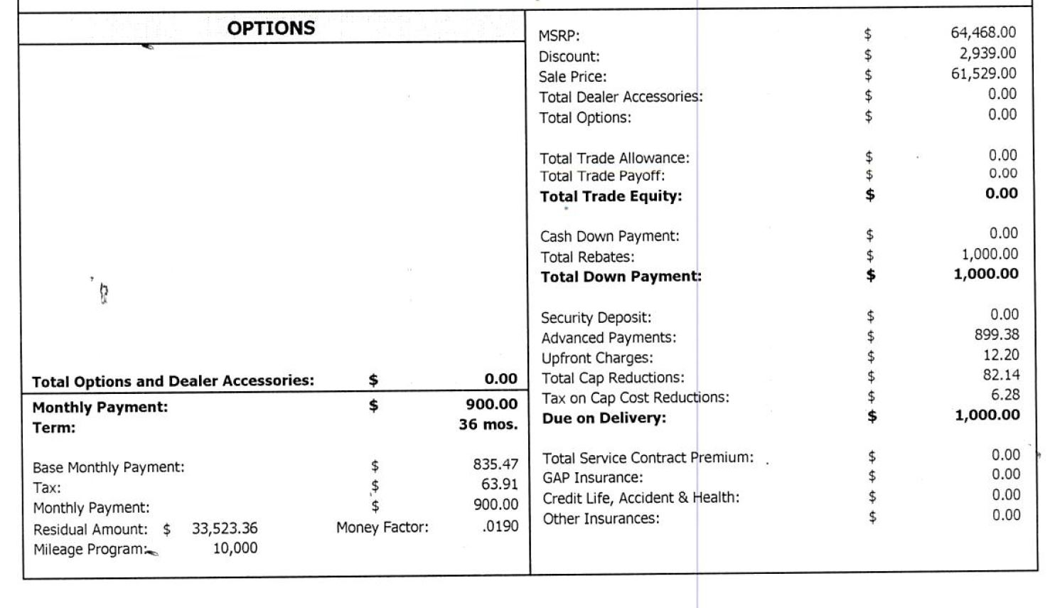

  • missp87missp87 Member Posts: 5
    My dealership has given me a lot of offers, and I am VERY confused. Hoping you can help! So here goes....:)
    25T R Sport in Colorado MSRP: 64,468
    10,000 miles, 36 months
    First offer:
    63,299 with 1,00 down and 1,000 rebate
    Payment without tax 867
    Money factor states .0290 but I think this is a typo and not sure if it was calculated into the numbers
    Second offer:
    60,529 with 5,000 down
    payment with tax and fees 756
    tax rate is 7.65 and $54 per month
    money factor=.0190 but must be .00190
    Third offer:
    Assuming 60,529 with 1000 down
    Payments at 815-830, not sure if this includes taxes or not or what the money factor is.
    None the less, I am very confused with how they are coming up with the numbers. I appreciate any insight and advice! Thank you
    First offer:
    Second offer:
    Third offer:
    All three offers against the same vehicle, same MSRP?
    Let's start with the basics - 36/10 numbers on the 25t R-Sport are 52% and .00001 (yes, almost free money).
    Any MF above that is extra profit for the dealer. Doesn't matter how big a discount you are getting off MSRP, that MF hike will kill your payment.
    Next - down payment. In short - we suggest you skip it. It masks the true cost of the lease, and that money might as well be thrown into a fire if the car is stolen or totaled. Only first payment should be due at signing in CO, since you pay registration separately. All other fees should be rolled into the selling price and the monthly lease payment.
    The number you want from the dealer is the adjusted cap cost, which is the negotiated selling price plus any fees (acquisition fee, dealer fee) added in. Get that number, and the full breakdown of how they arrived at it from the selling price you negotiate.
    However, let's do some calculations with the prices we do have, and the base MF quoted above.
    Offer 1 - $828/mo plus tax
    Offers 2 & 3 (since they are the same price) - $751/mo plus tax
    Suggest you use this link to build your own calculator:
    https://www.edmunds.com/car-leasing/calculate-your-own-lease-payment.html
    BTW, which dealer are you working with, that is charging up the wazoo on the MF? I've heard not-so-nice things about Stevinson on Broadway, as they are losing their Jaguar dealership soon (will be combined with the Land Rover Denver store further south on Broadway).
    This is VERY helpful, I can’t thank you enough!
    Yes, all offers with the same MSRP. This has been an interesting experience, I started this process with one salesman and then had to work with another for timing purposes. I am fine/understand but a lot of information was lost in transition. (Corporate rebate codes, down payment preferences, etc)
    Another peice of this puzzle is I am trading in my current leased vehicle. My payoff amount is $1,600ish less than the auction price, minimal equity. They are considering it a wash, which is why I did not mention it earlier.
    The MF has no bearing on my credit score, correct? Again, I don’t think they are typing their MF correctly via email or on invoices (“.0190”) But I mentioned it being above the base and was told....”Typically when you get in the higher trimmed cars, the MF changes.It is different for every trim level and even depends on the options it has. Each car comes with a code from Jaguar for the MF” Any additional advice you have? Walk away? Ha!
    I will ask for the adjusted capital cost, that has not been provided to me and I can’t make sense of any of the offers in any online calculators I have used. They did tell me on the second offer they were only making $200 on my deal. Based off of their invoice price and the price they were selling it to me for.
    I completely agree on the down payment front, and have never put any money down on a lease and certainly don’t plan to. I recently relocated to Colorado, so I appreciate you telling me about the registration as in Missouri I did not have to pay registration fees. I haven’t been able to find a calculator for this, do you know of one?
    I am not working Stevinson, but honestly I couldn’t say enough good things about their dealership. I did not get into hard numbers with them as they did not have the trim I was looking for but I did test drive the S model and the salesman I worked with was really great! I am sure it is a different story when you getting into the numbers game.
    Thank you so much for your time!

    Thank you, can you also tell me the MF for 39 months/10,000 miles? Still on the 25T R Sport.
    Sorry I am so needy, I am pretty clueless when it comes to this stuff but I greatly appreciate all the help and advice. This is what they sent over this morning, I STILL can't get the numbers to add up, all the calculators I use have higher numbers. I feel like there is something missing?
    tneis said:
    So fast thank you. Provide the same for the 25t AWD R-Sport as well. Thx!
    52% and .00001
    49% and .00011
    I don't see the acquisition fee called out anywhere on that document.
    If this is the 25t R-Sport, the 36/10 numbers are 52% and .00001. Using the MSRP and sale price from the document, I get a payment of $778.88/mo before tax.
    One of two things:
    1. The sale price is not the same as the cap cost used for the payment - as noted, it may not be, as the acquisition fee isn't anywhere to be found. Get the cap cost from the dealer.
    2. The MF has been marked up by the dealer for extra profit.
    @missp87
    The money factor just isn't right.
    Even if the numbers were semi-correct, it would be .00190 with two zeroes, not .0190
    Try this in your next communication:
    "Hey... give me the actual @#$% money factor you are using... it starts with a decimal point, followed by at least two zeroes!"
    Alright, so the money factor is .00019. Acquisition fee is $895, $599 dealers fee, and $495 deposition fee.
    I would assume I can just ask for a lower MF? This is the first time I am negotiating my own car, I am not very good at it. Thank you again for all your help and advice.
    edited April 2018
    If it's .00019 (and not .00190), then it's just marked up a little bit. Maybe $20/mo. extra.
    The disposition fee is charged at lease end, so it's not part of the equation.
    It does look like the money factor is .00019.
    To get the pre-tax payment, the adjusted CAP cost is about $62940.
    How did they get there?
    $61529 sale price
    +$895 acq.fee
    +$599 dealer fee
    -$82.14 CAP reduction.
    In the example shown, it looks like the $1000 rebate is covering the first payment and CAP reduction. I think the $900/mo. is Sign and Drive, with $ZERO out of pocket, not even first payment.
    The base money factor would drop the payment to about $881 from $900.
